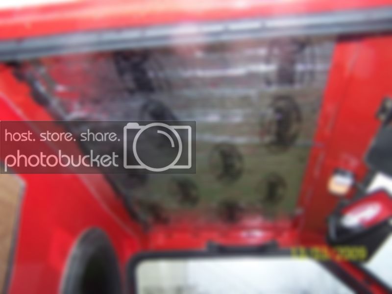

Yeah I getcha, I didnt see the doors had those recessions so the boxes fit in there nicely eh
Gotta be careful when you get those subs moving that you dont let them excurt into the SEAT, looks tight....

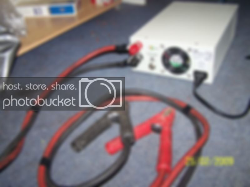

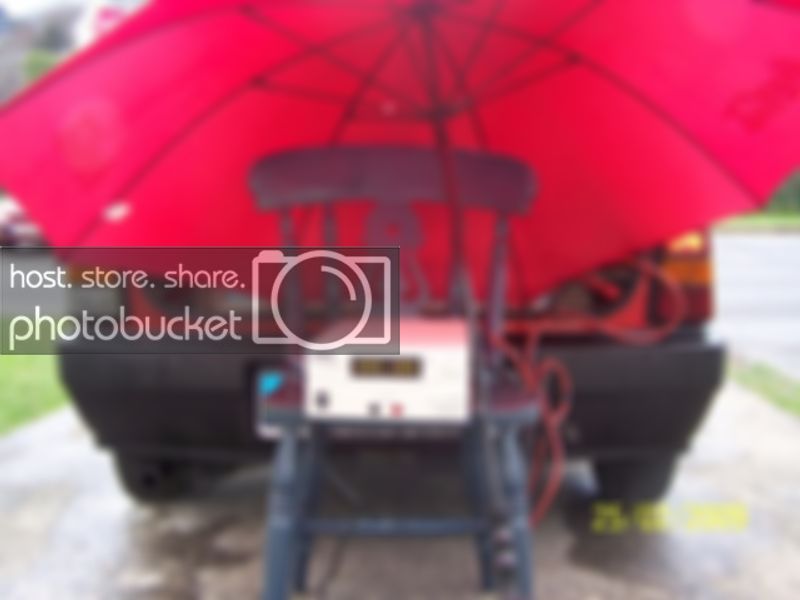

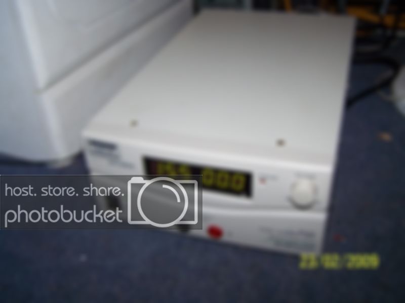

Finally got the power supply/charger //content.invisioncic.com/y282845/emoticons/smile.gif.1ebc41e1811405b213edfc4622c41e27.gif
Dam pissing here today, so thats the solution lol

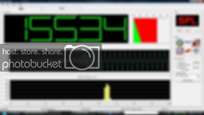

Swapped the RCA cables back like they were at the first stage and 155.34 db
So seems while im using the RCA output from the faulty amp the result gains by nearly 1.5 db ...

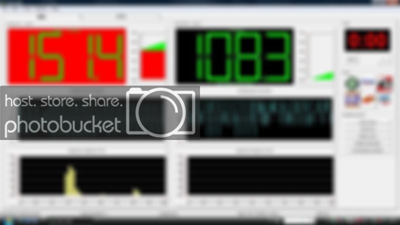

Made some Propper Dropper tests

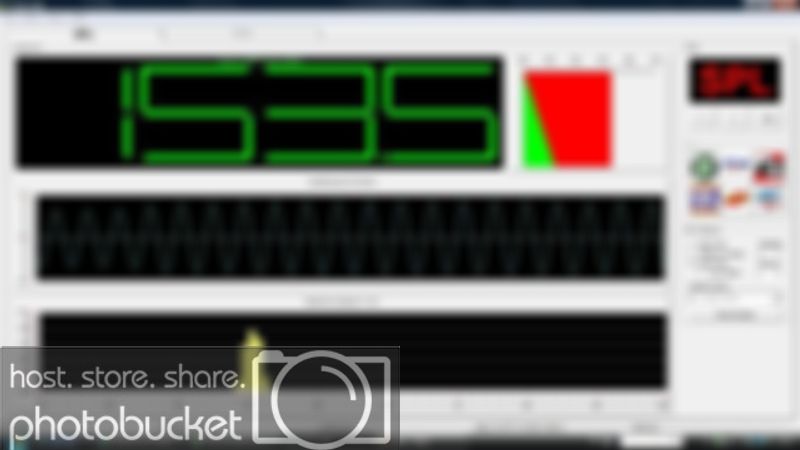

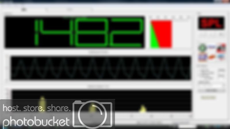

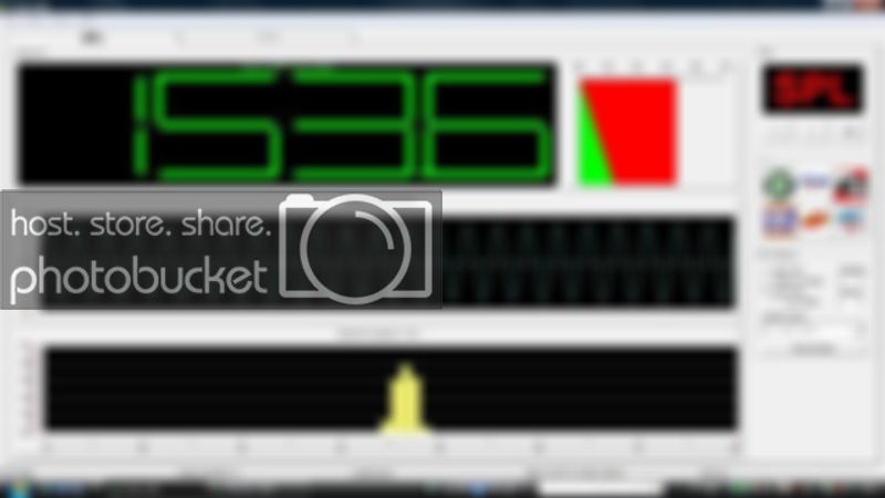

20hz, 25hz, 33hz and 40 hz peak
So far:
very poor result on 20 hz --- 141.5db
much better on 25 hz ... 148.6db
33hz 149.8db
40hz 153.8
Couple pics, but these were not the highest but very close to the results i got //content.invisioncic.com/y282845/emoticons/tongue.gif.6130eb82179565f6db8d26d6001dcd24.gif
25hz
40hz
