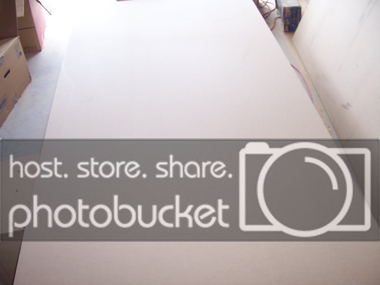

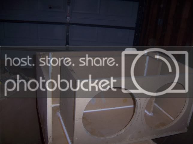

You know...Its how they all start....a Simple sheet of 49x97
cut into tiny little pieces..
and then assembled, quite nicely

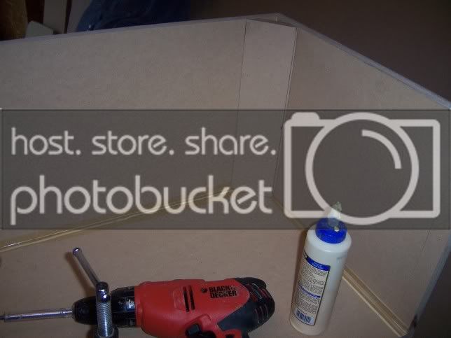

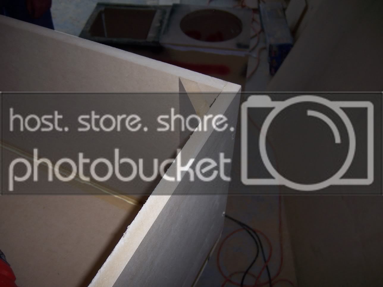

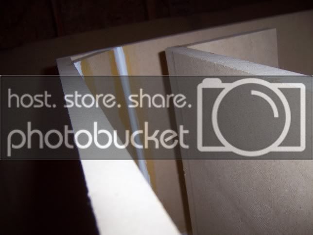

heres a shot, of the beginning of the 45 degree angles
and instead of screwing them in, and increasing turbulence in the port, i used glue, and clamps..

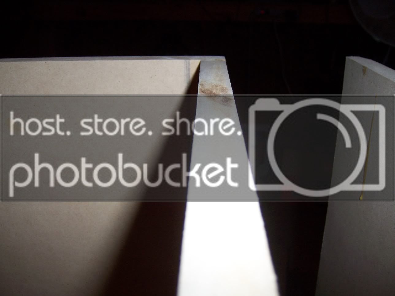

here is the second 90 degree turn, of the port.

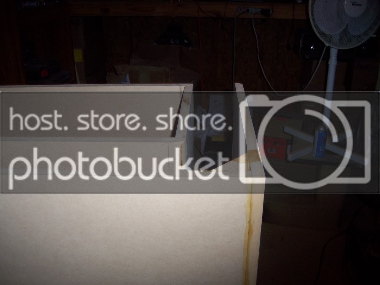

No better way to so it, but to seal it up right
More of teh caulk

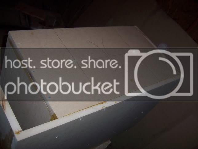

in this one,m the front, and the port are both in, and then i traced around all of that, to drill through, just so i woud be able to attach it to the bottom of the box (the front, and port that is
Down the other side
