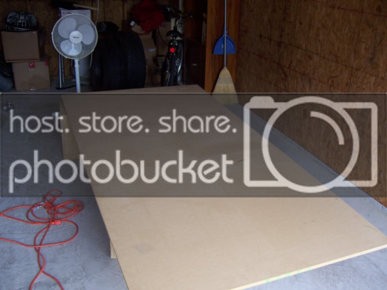

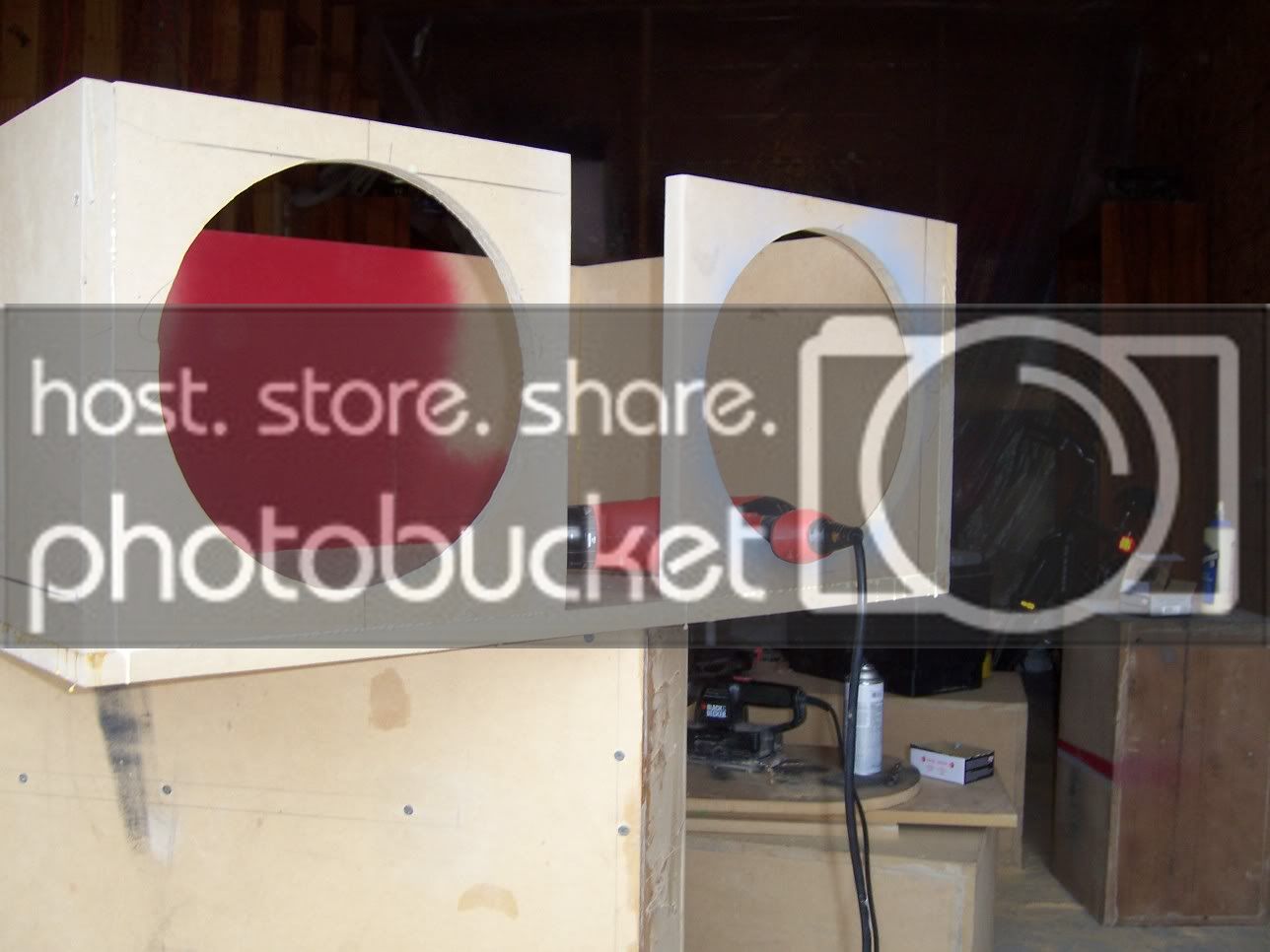

the first shot is a shot of what it takes to create something usable in the first place.
A saw, and raw MDF

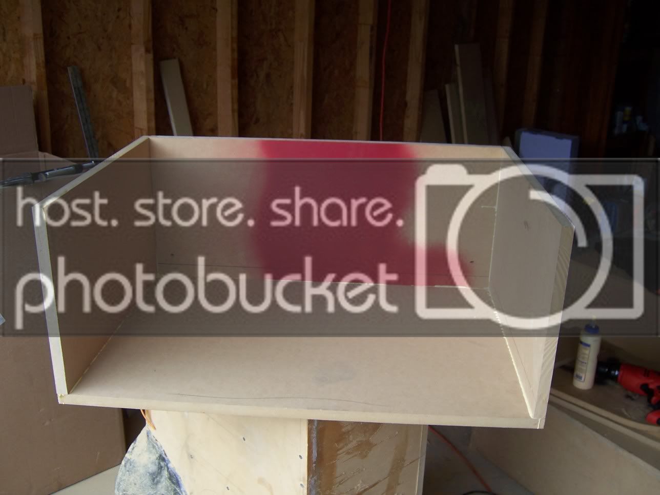

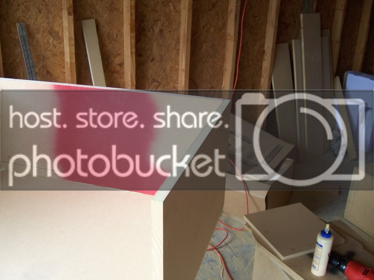

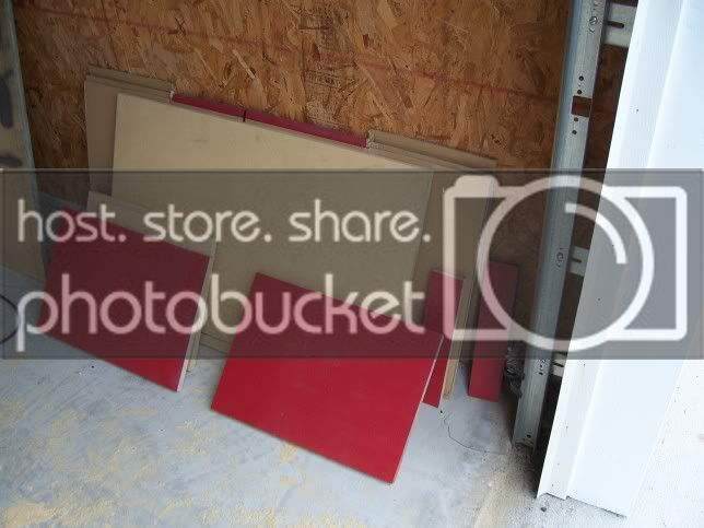

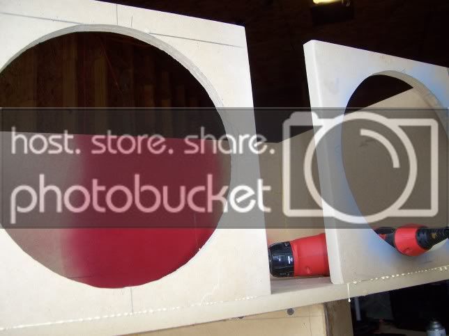

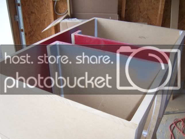

Here i have most of the pieces cut and the port pieces are painted Red, as requested.

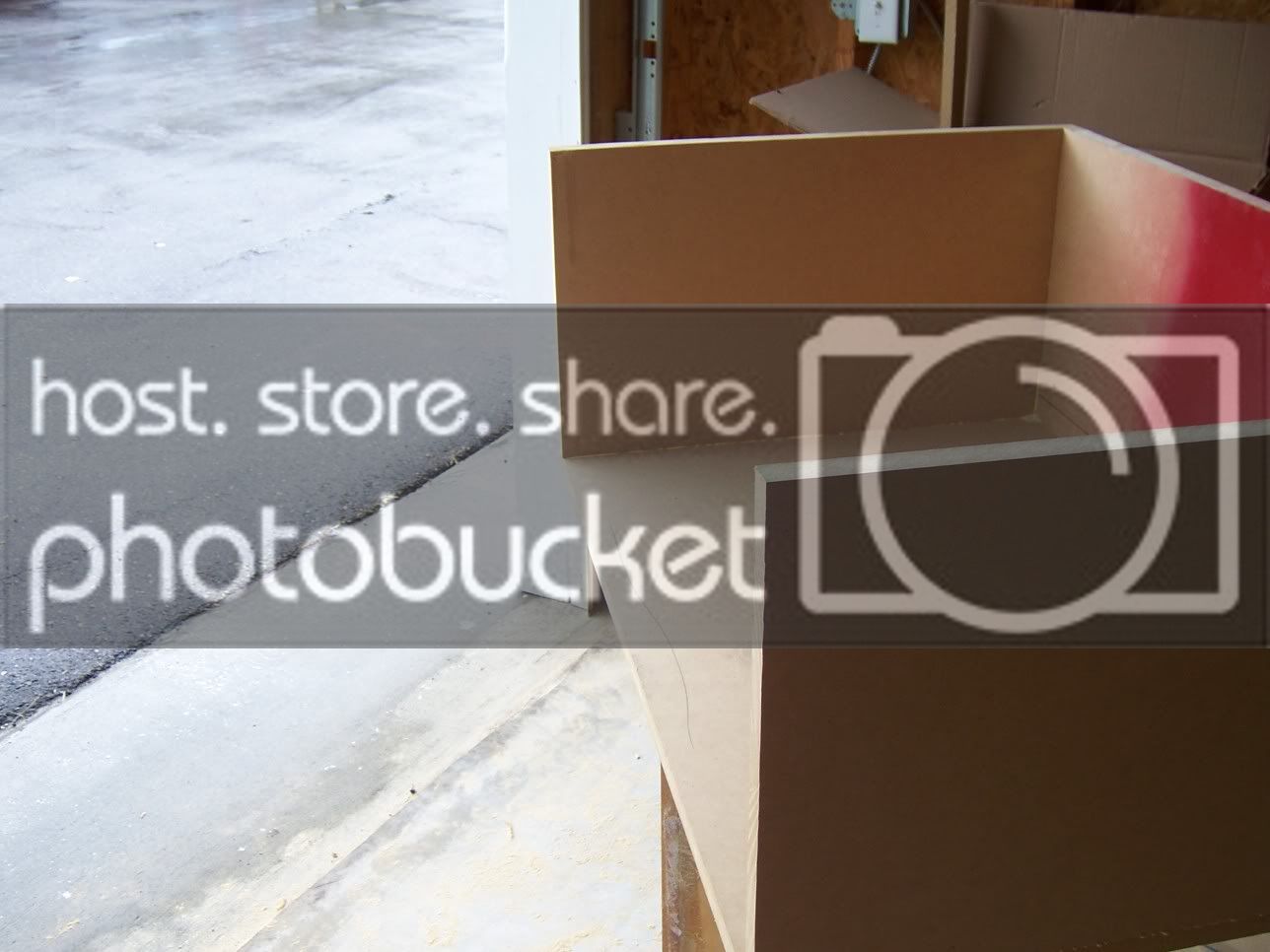

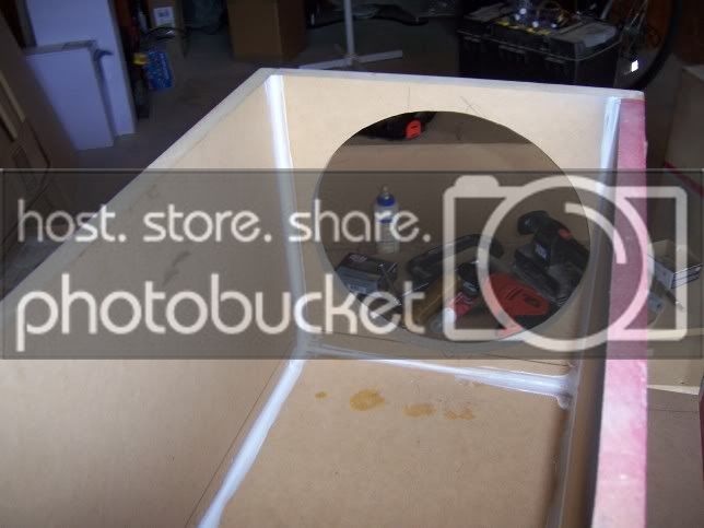

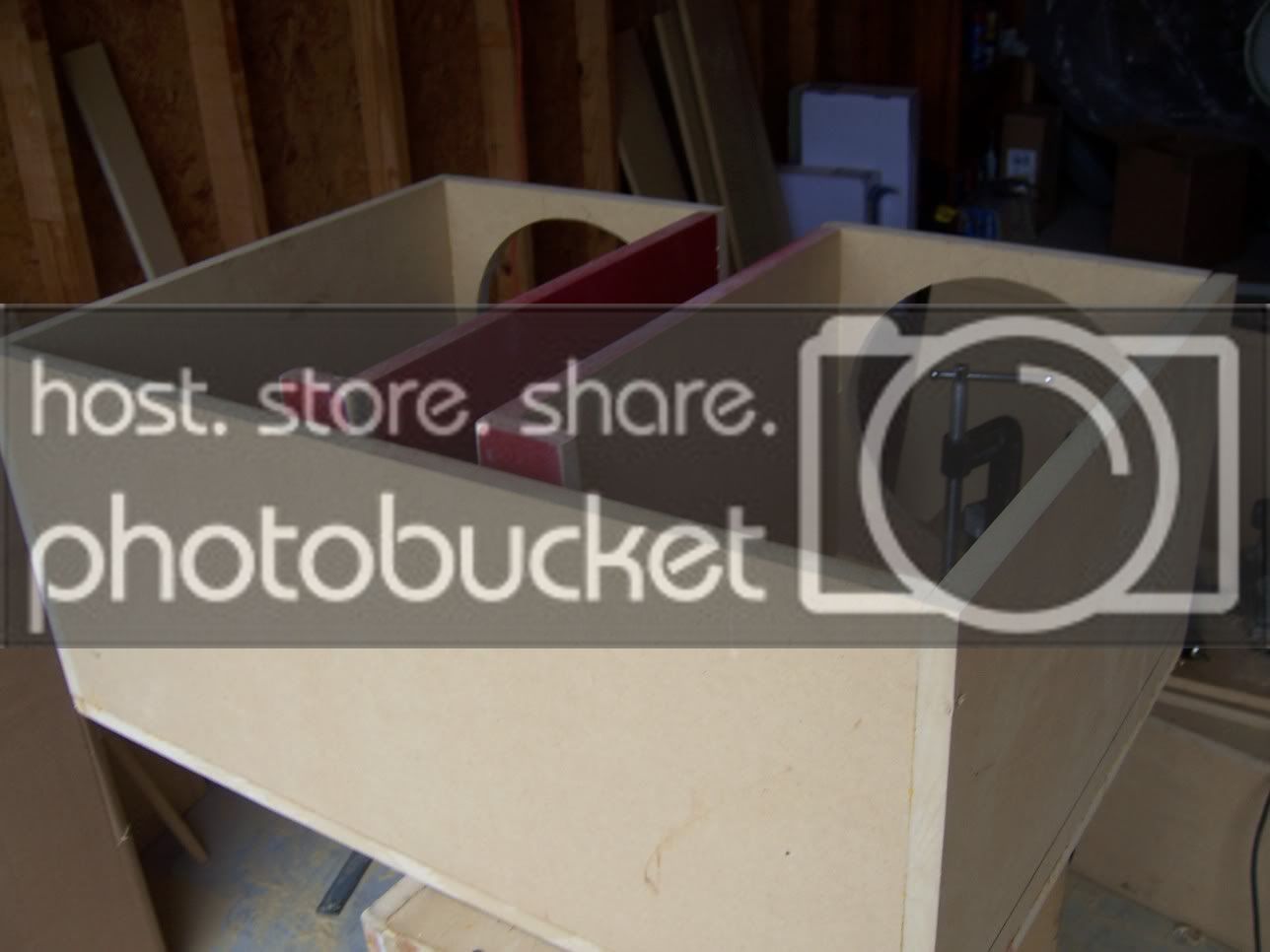

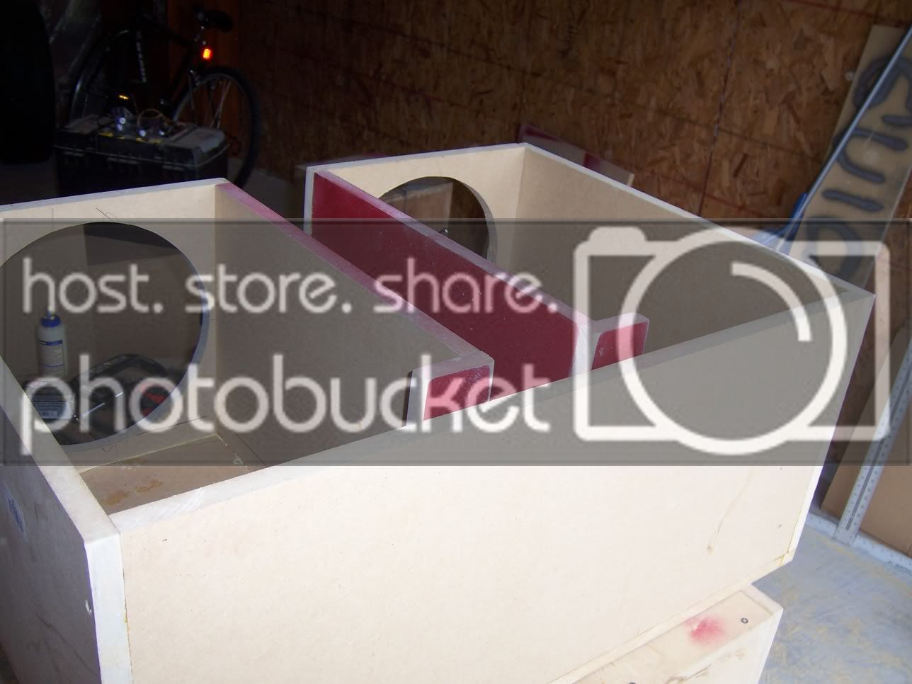

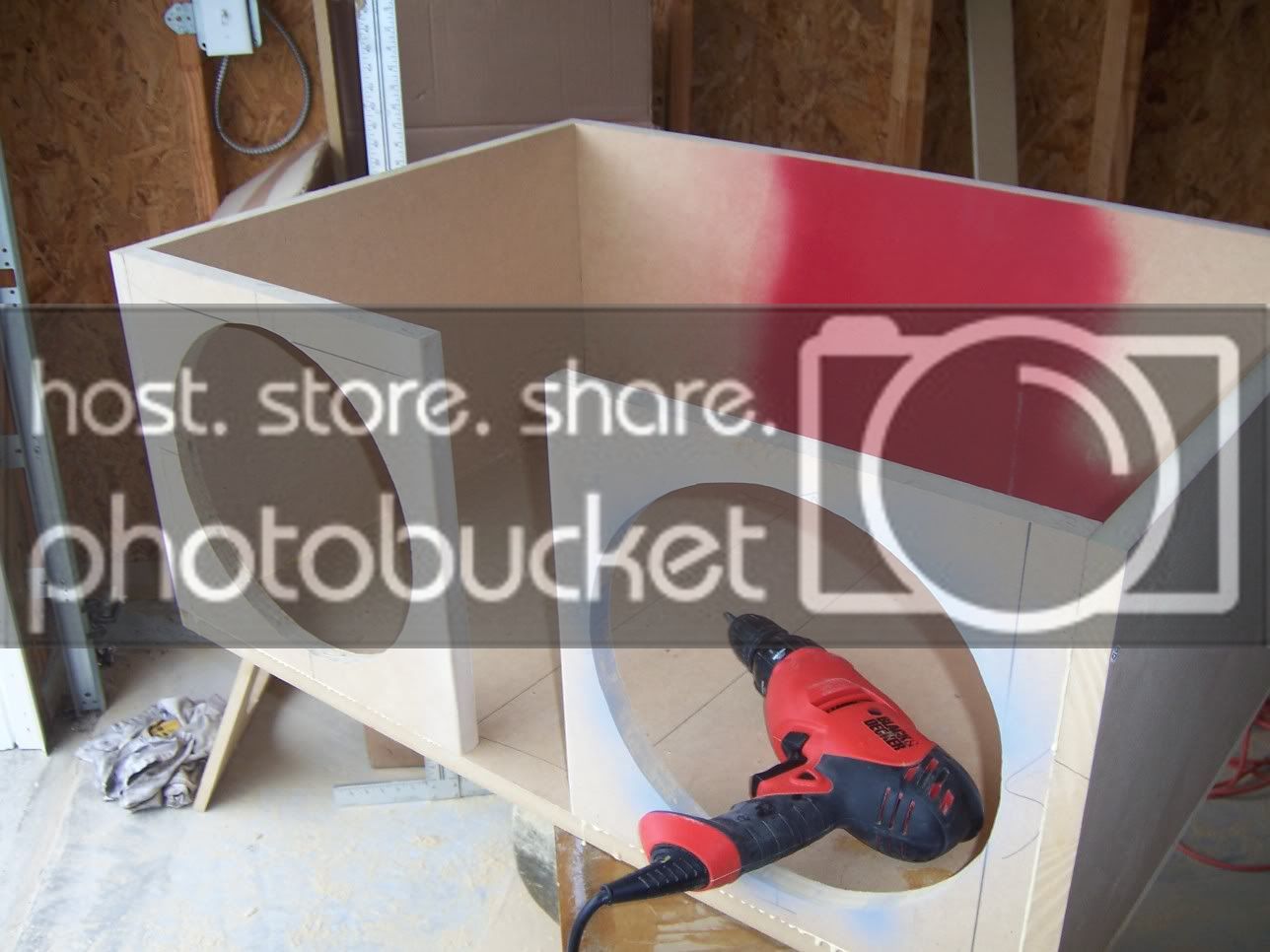

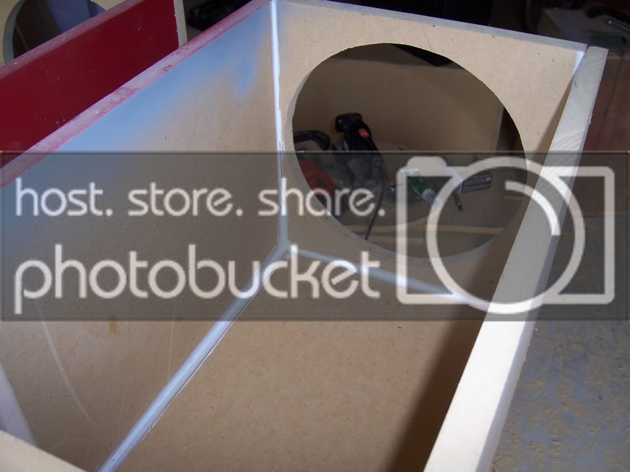

here it is with the sides, and the back wal attached

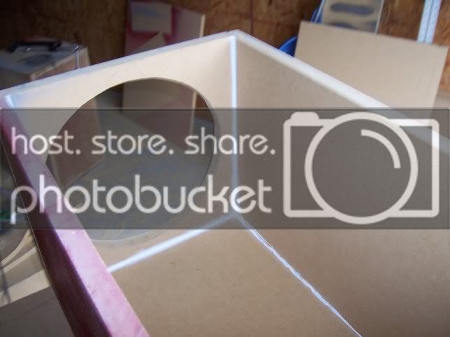

A little closer

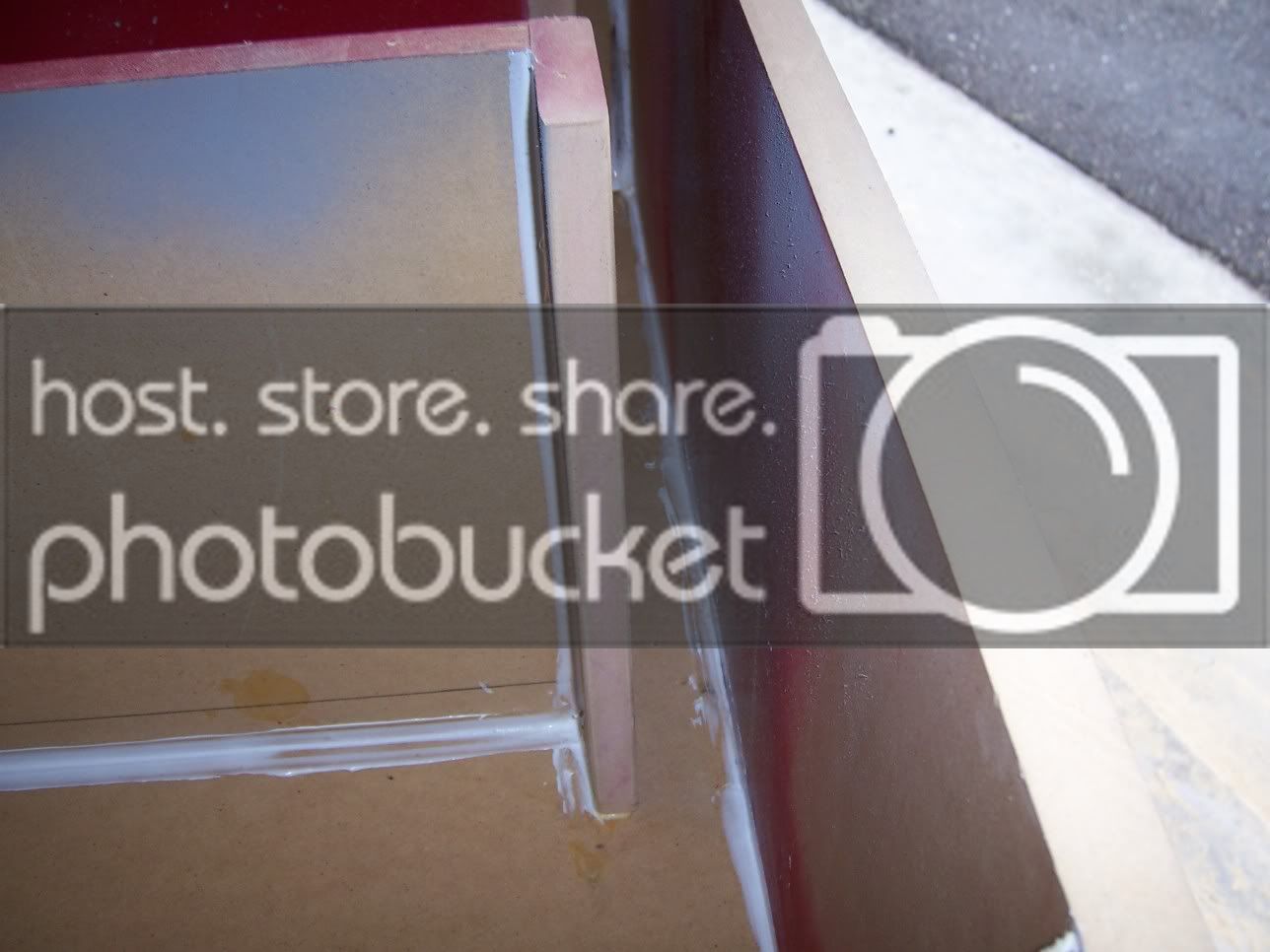

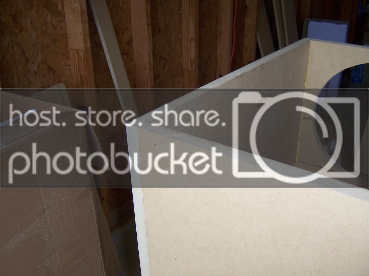

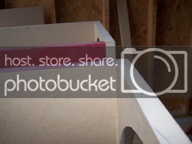

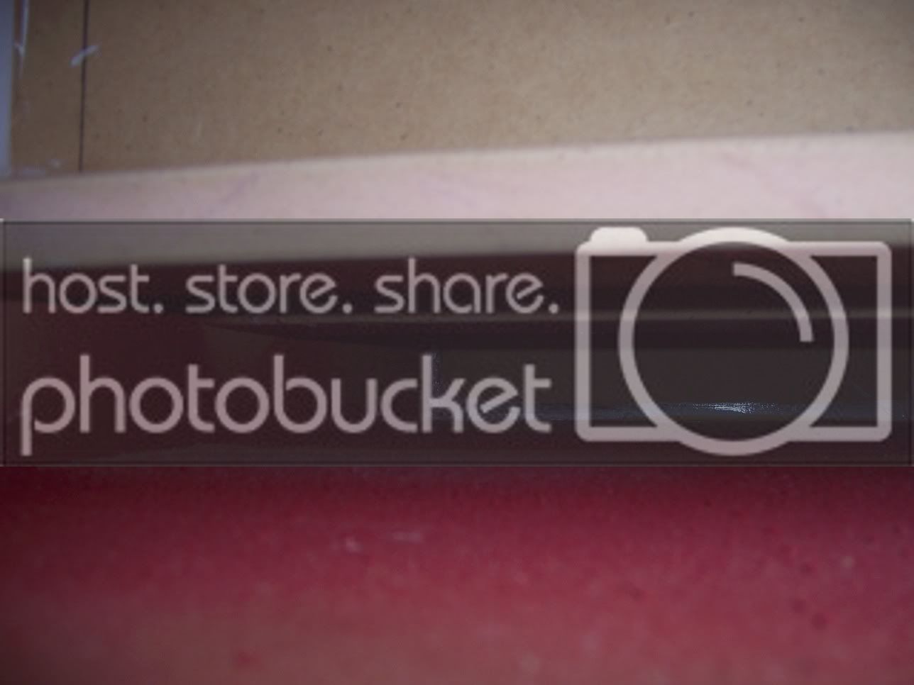

Showing off the perfect lining up of the corners

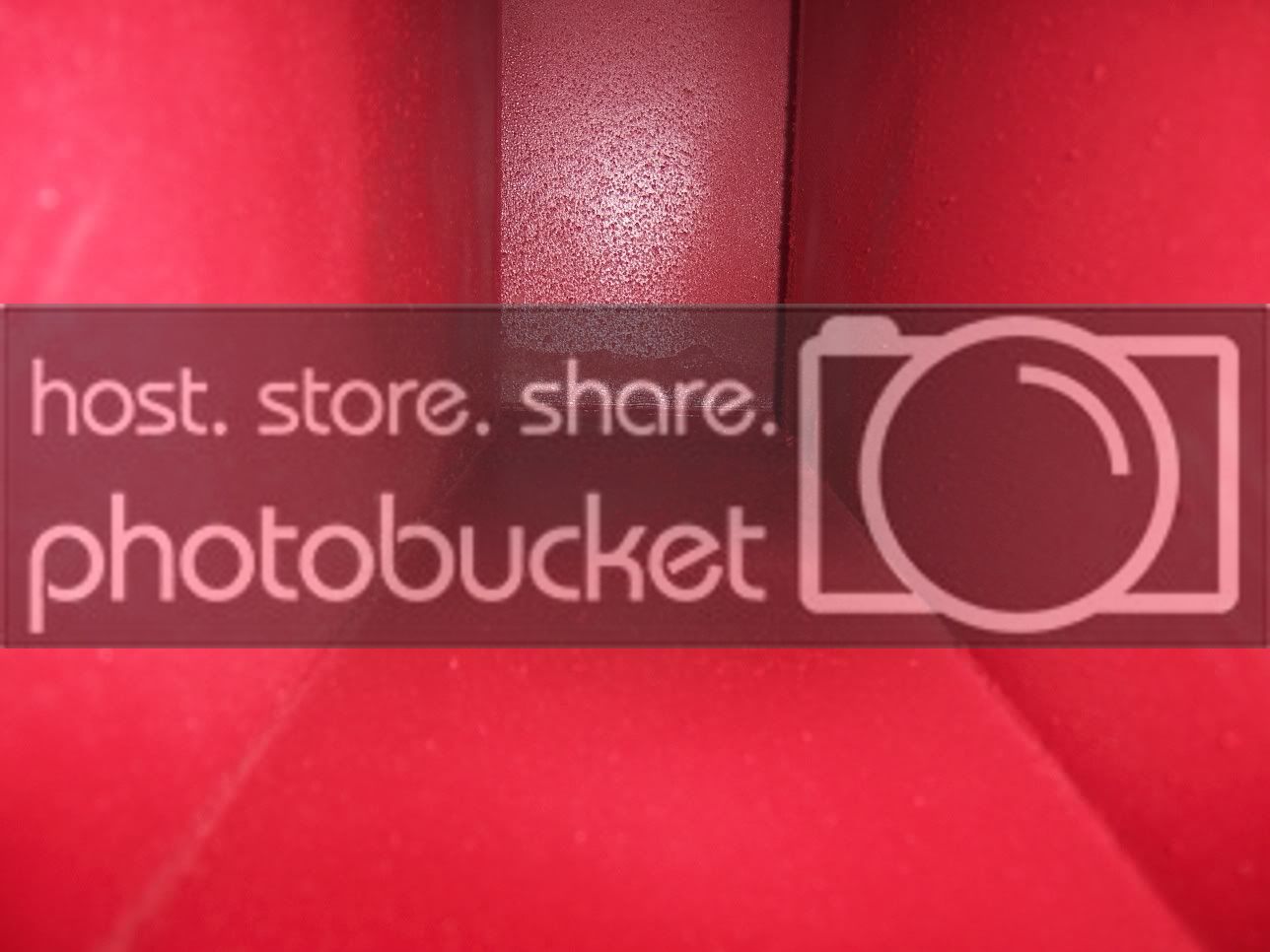

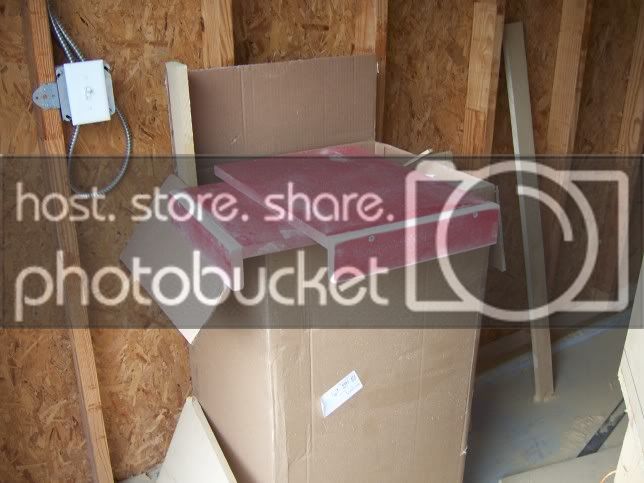

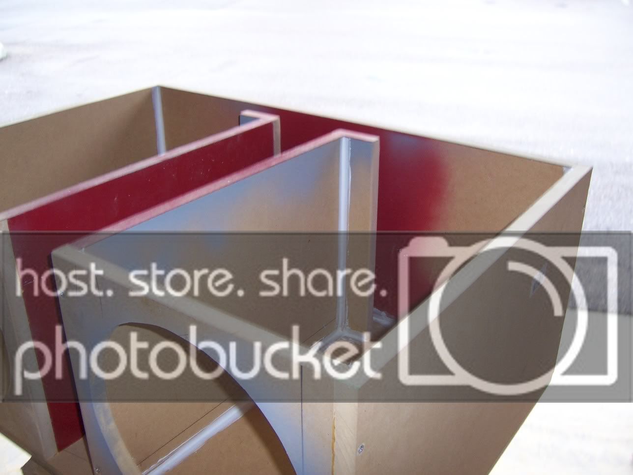

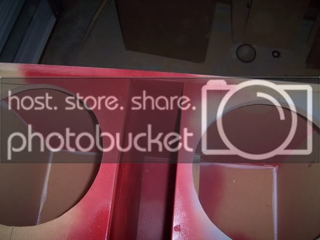

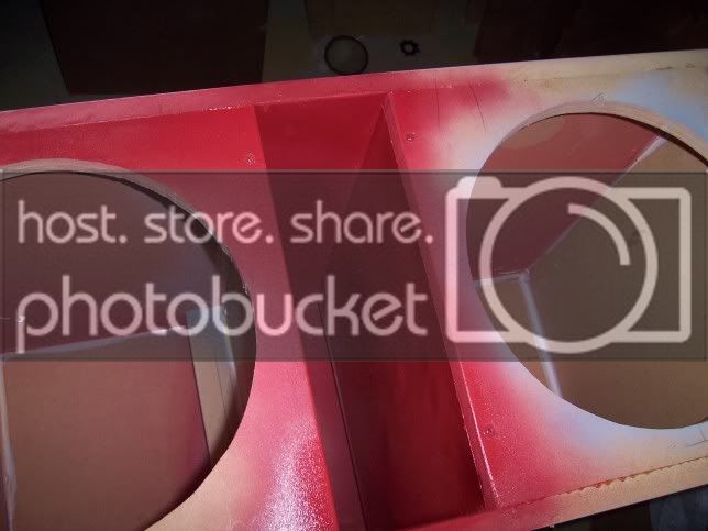

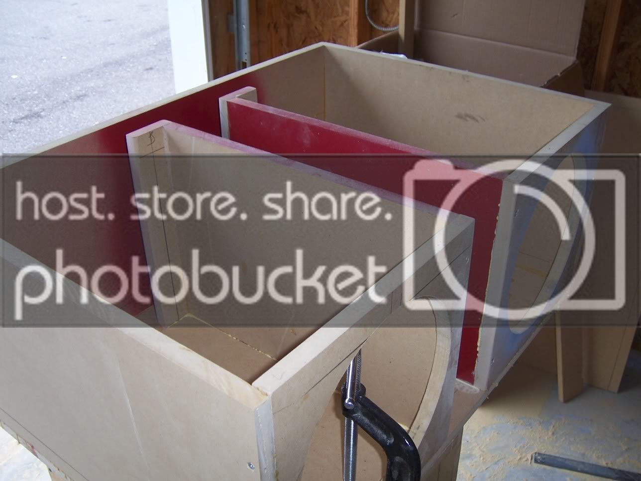

Building of the ports. it is 4 inches wide on the face, and extentd along the back wall @ 2 inches each side, for 2.75 inches, giving the required length, to get the proper tuning

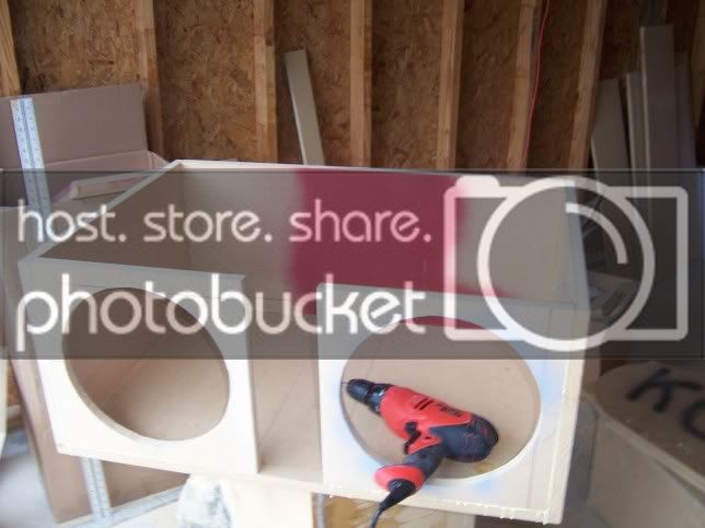

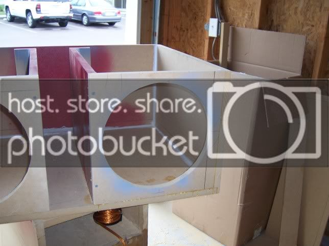

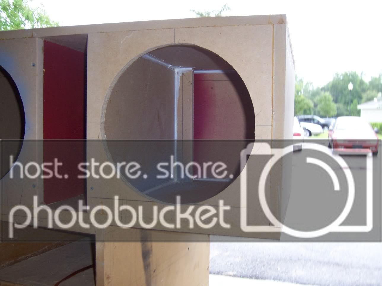

Front Baffles attached

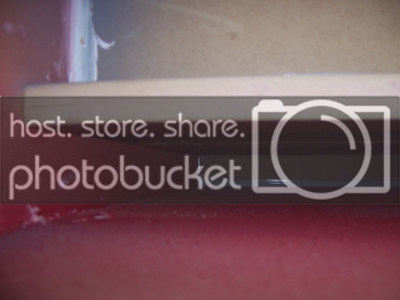

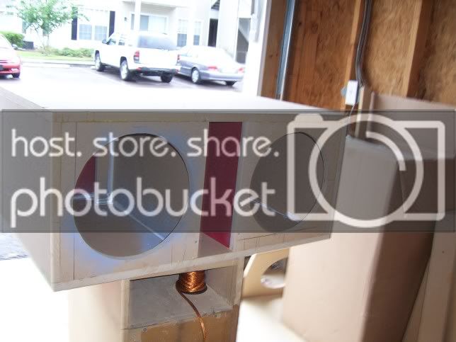

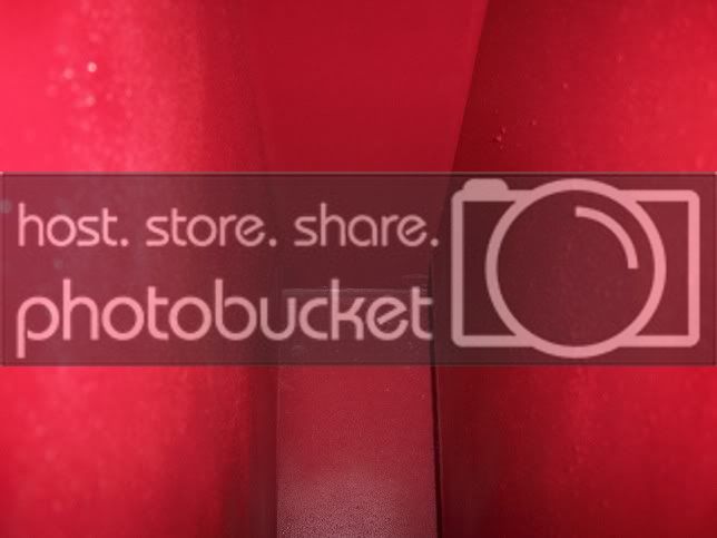

Had to keep the ports nice and round. I am impressed with the way taht this one came out.
Still showin off them corners.

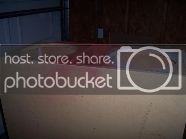

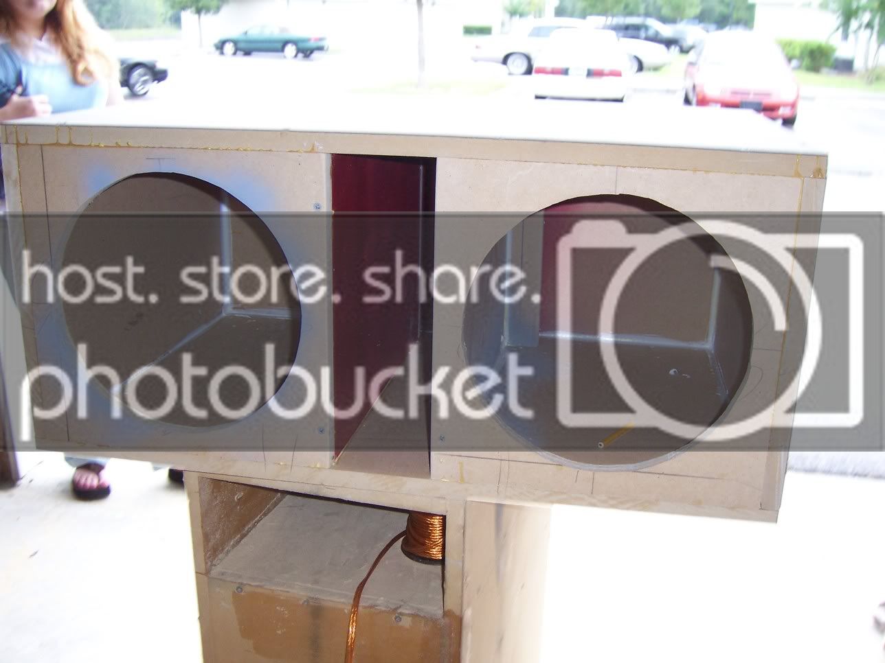

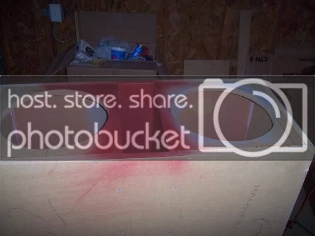

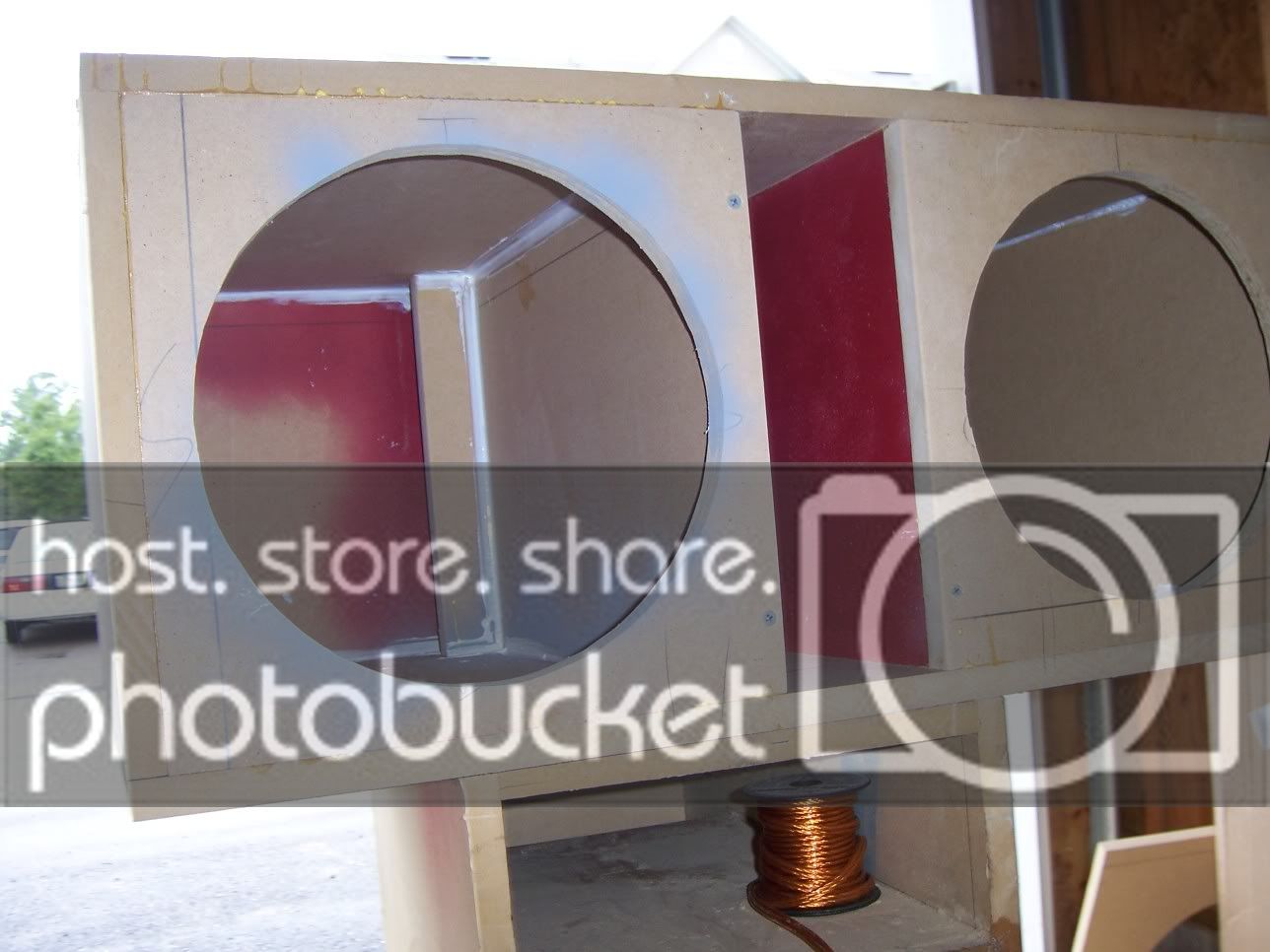

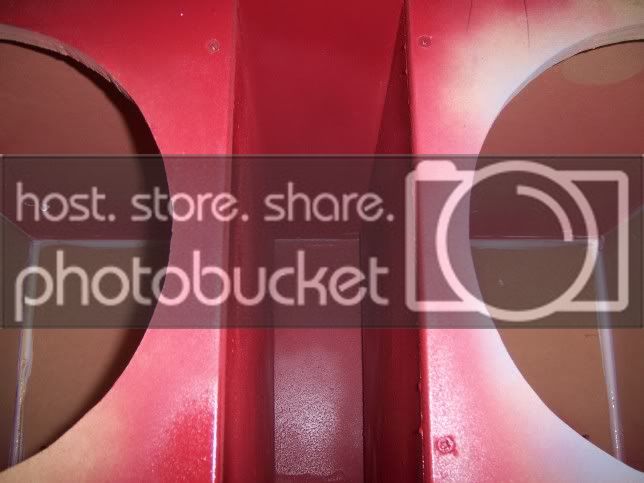

Front baffles and ports attached.
how does a dual flare at the end affect tuning?
well it starts off 4 inches on the front, and i split it in half, for the backside. where it splits, it is 2 inches on each side. but the port area is the same, so its no different than a basic L port, minus the fact that that isnt practical for this box, hence the flare.
