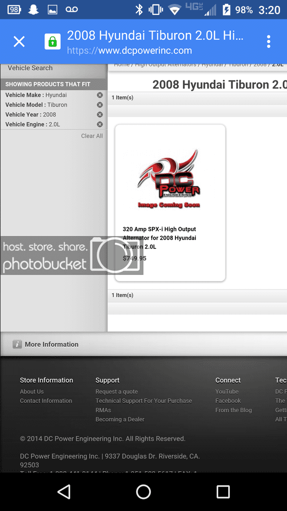

Anybody replaced the alt in a Tiburon before? I'm wondering where to buy one, seems like high output alternators are hard to find for Tiburon's.
2.0 is a breeze from my understanding its the same as in my Elantra. You literally just remove the oil filter and remove it from the bottom. DC Power and Singer both make one, but I'd swing with Singer because he has more options. I currently went with the 240amp so I can charge at idle, but I believe he offers a 300 and 320amp as well. The V6 was the one that was kind of sketchy IIRC.
Holy motherfucking ****, lol
I requested a quote from singer, hopefully it's a lot cheaper
