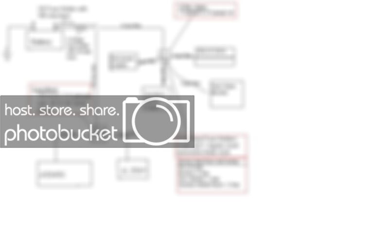

So this is what I've got so far:
Comments and Suggestions welcome.
I always fuse to the wire not to whats at the end especially when whatever is at the end has it own fuses; amps and power converters. 0 Gauge wire 300amp fuse and 4 gauge wire 130 amp fuse. Never ever had any problems. also gives u room to upgrade.
I'd rather fuse lower and be safer. I realized the wire could handle a bigger fuse but when I'm drawing less then 125 amps why should I use a 200 amp fuse? My amps don't have fuses, and neither does the eq, media player or monitor. I can always just put in a higher fuse later on if need be.
