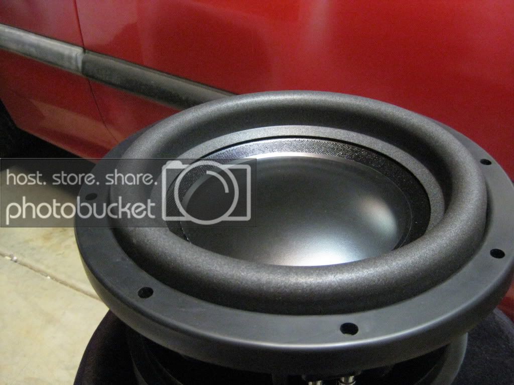

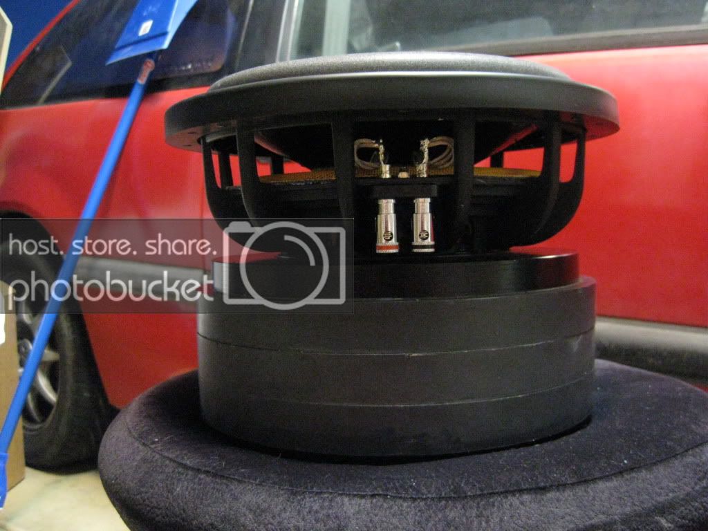

I built that myself, it is an underhung neo motor, with a Tumult VC, 25mm Xmax, 30ish Xmech, it works but it turned out to have a very high Q and low efficiency BL~10, But it seems to handle 2500wrms quite well(for short periods). Works in a largish box tuned to mid 40's, sounds better than I expected.

AWESOME WORKMANSHIP!//content.invisioncic.com/y282845/emoticons/peace.gif.2db28b618ed8d1964ebbe2f5021d2c39.gif

It's a very cool looking project for sure //content.invisioncic.com/y282845/emoticons/smile.gif.1ebc41e1811405b213edfc4622c41e27.gif

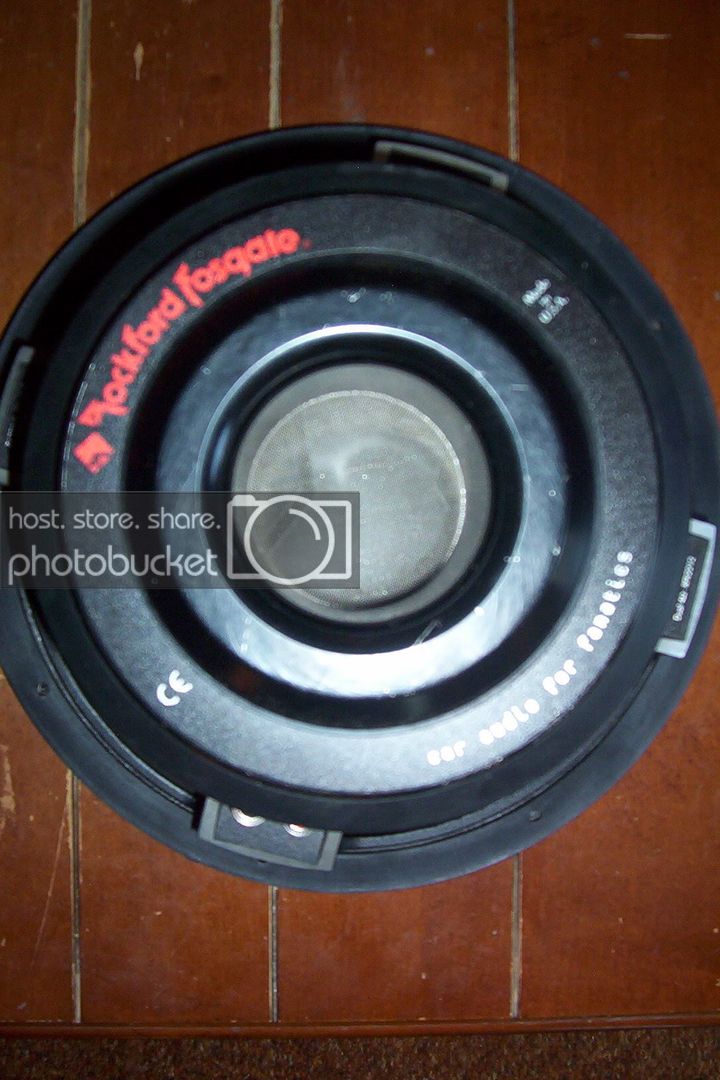

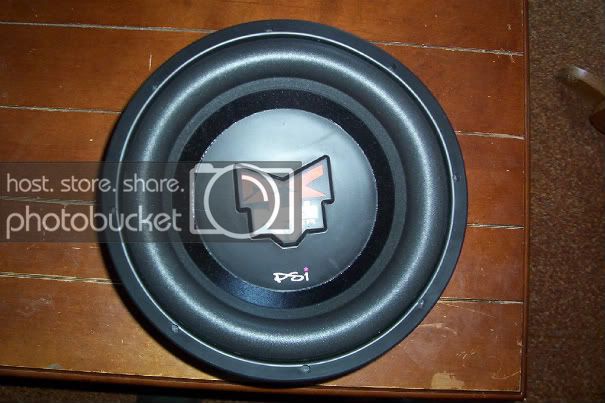

power dvc NOT the power hx2. this is its daddy:D 4 inch coil monster. 4 spoke rockford basket,original dust cap! reconed by team psi with better parts. betcha dont got one of these:p:
