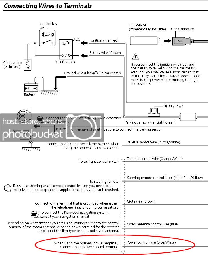

i just hooked up a kenwood ktv 617 HU and the brain is really big so i had to run that to my trunk because its wayy to big to fit in the dash. basically it just has a power cord a wire harness and rca's. the HU works fine, so do the speakers, but my subs wont come on now. i checked all the fuses, under the hood, etc. and no power at all is being generated to the amp. what could be wrong? im so confused
wont turn on... im a noob btw. im guessing its a fuse somewhere but i really dont know because i dont see any blown and it worked fine before i wired this up last night.
REM wires are blue/white, but Kenwood calls it the Power Control wire.
theres a blue one. its for the antenna the sticker wrapped around it says. but the white ones are hooked up. from what i remember:
gray>gray
gray with stripe>gray with stripe
black>black (ground)
red>fat yellow>red>yellow (power wire)
green>green
blue/ taped off
pink/ taped off
brown/ taped off

^^^^ wrong? you sure its antenna?
there WILL be a blue wire with a white stripe on it for remote wire.
