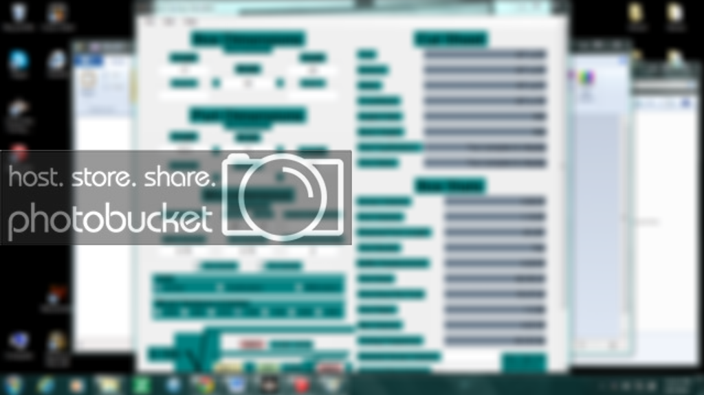

Drawing it up is the best thing. Keep in mind every calculator may have a set end correction factor, like if a port is slot vs. just a square port say in the bottom of the box then their port lengths will be different. But at the same time, you have less consequence on port length because usually it's just a couple of inches of error, so depending where you're trying to tune, you're still not terribly far off.

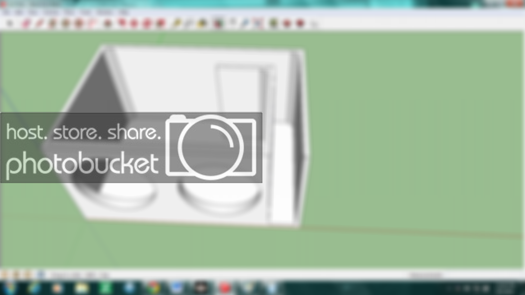

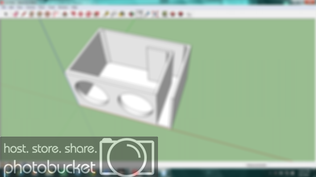

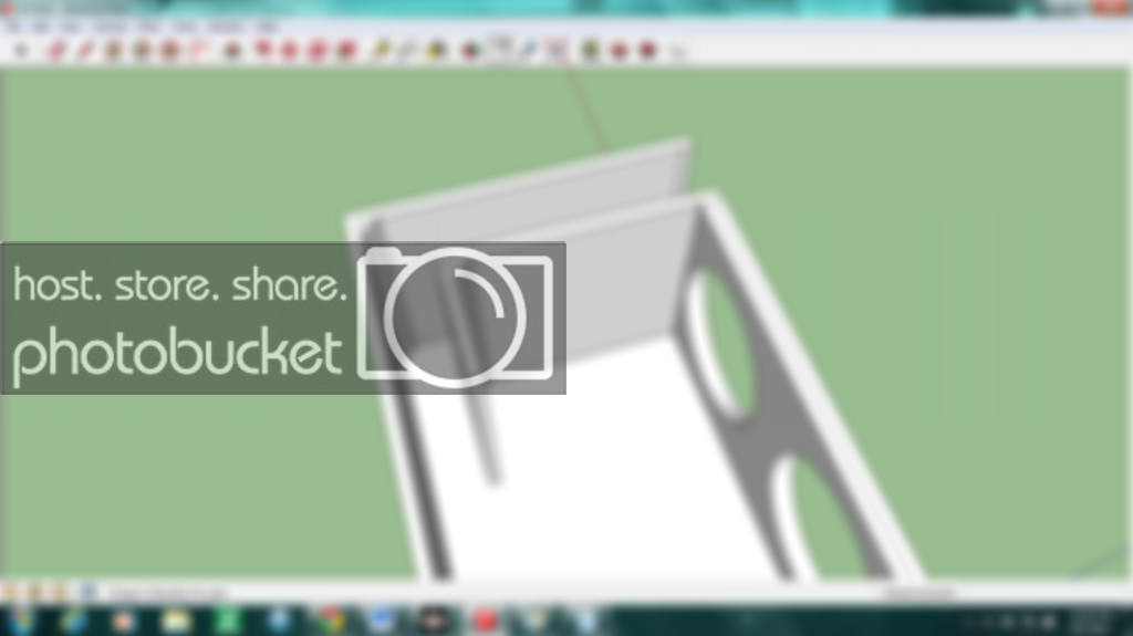

Ok the box specs changed a bit as i didnt realize the box was not what i wanted. New box dims are 17H x 33W x 23D. Port dims are 15.5H x 4W x 29L. So the center line is now 23 -.75 - 2 = 20.25 from front to back, the side is 29 - 20.25 - .75 = 6 from right to left. The actual port wall is now 20.25 - 2 = 18.25 from front to back, and 29 - 18.25 -2 = 8.75 from right to left. Sound about right? I did a sketch up and fixed torres, hopefully this looks right :D
Port from the front:
Port from the side:
The port measures 4" from the top of the box and the side of the box. port wall from front to back is 18.25" and from side to side is 8.75. Lemme know if anything is off. I do plan to do round overs and ill fix the top of the box after i make sure the design is correct.
@loudlittlefvkus ; Thanks for looking at this man.
That makes sense. Also would explain why torres "physical port length" doesnt match mine. I drew it up and posted it up, maybe you could take a look at it as well? //content.invisioncic.com/y282845/emoticons/biggrin.gif.d71a5d36fcbab170f2364c9f2e3946cb.gif
