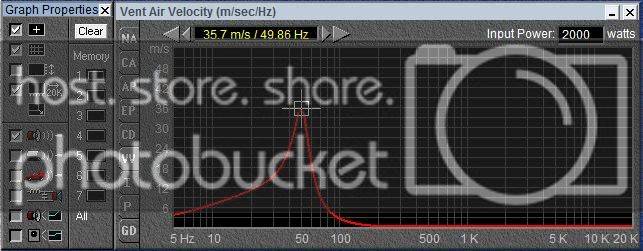

well this is what i came up with using bassbox pro 6. as you can see the program asked for a lot of numbers i didnt have but i'm pretty sure the chamber volumes and port dimensions are what they should be
the graph shows 35.7m/s max velocity

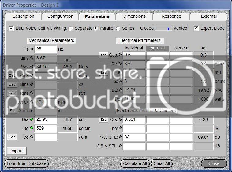

i'm not sure how youre wiring your subs but i assumed parallel/parallel but these are the parameters entered

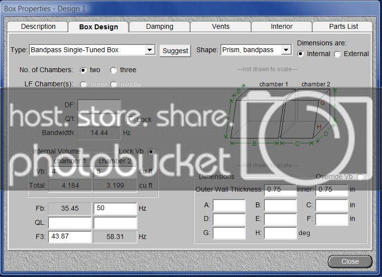

the box part was new to me as i've never used the software for a bandpass box before but this is what i entered there
