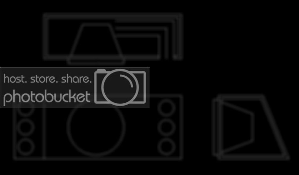

I'll be building a new for my type R using PVC pipes, but the ports are ending really close to the sub, is this right or should i redesign the box to put the ports away from sub.
Box specs:
Net volumen: 3.85 ft3
Ports: 3 x 4"
Port leght: 22
Fb: ~32hz
This is the draw of what i have, the center line was to measure the port.
redesign it man.
Also, it's not a good idea to have that many ports for this design either.
It could offset the tuning.
It'll have just 3 ports, the other 3 are just for the look, i like symmetrical things, i can just move the sub a little to the left and port will have their clear area.
or Should 2 4" ports be ok for a 15" type r?? cause that will short the leght of the ports.
OK, hehe, as long as it isn't 6. Kinda scarin me there for a minute.
You dont want the rear wave to escape as soon as it attempts to pressurize inside the box.
