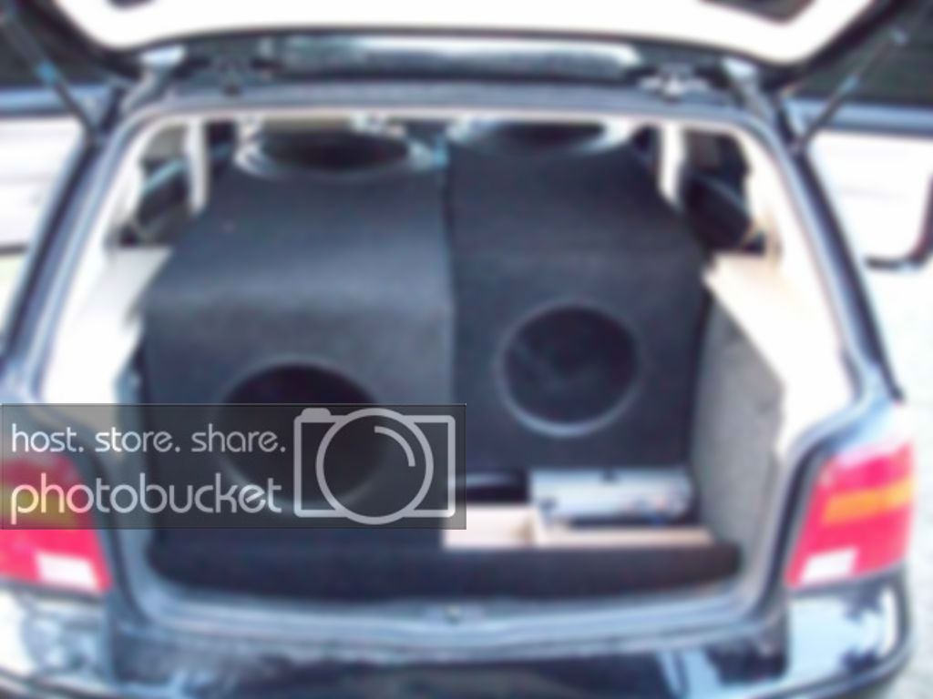

why 10? get a bucket!
i hit 148 if i remember it correctly...
2 18s strokers...we just did it for fun...
i actually competed with it..
yeah, i got laughed at LOL

O M G !!!//content.invisioncic.com/y282845/emoticons/eek.gif.771b7a90cf45cabdc554ff1121c21c4a.gif
SICK......
