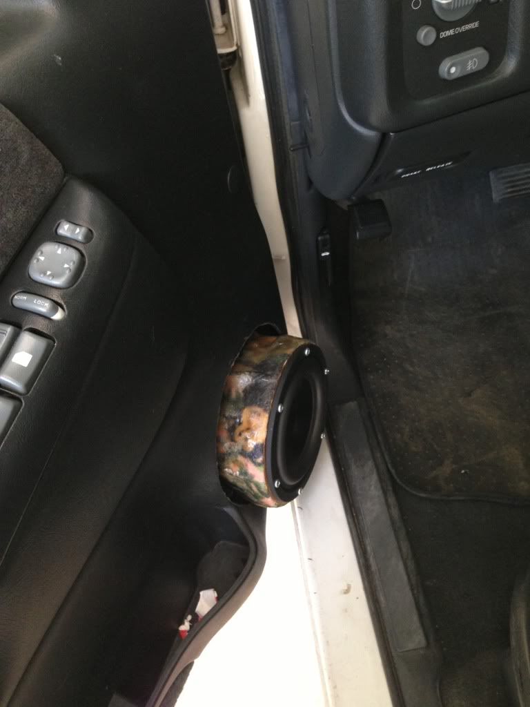

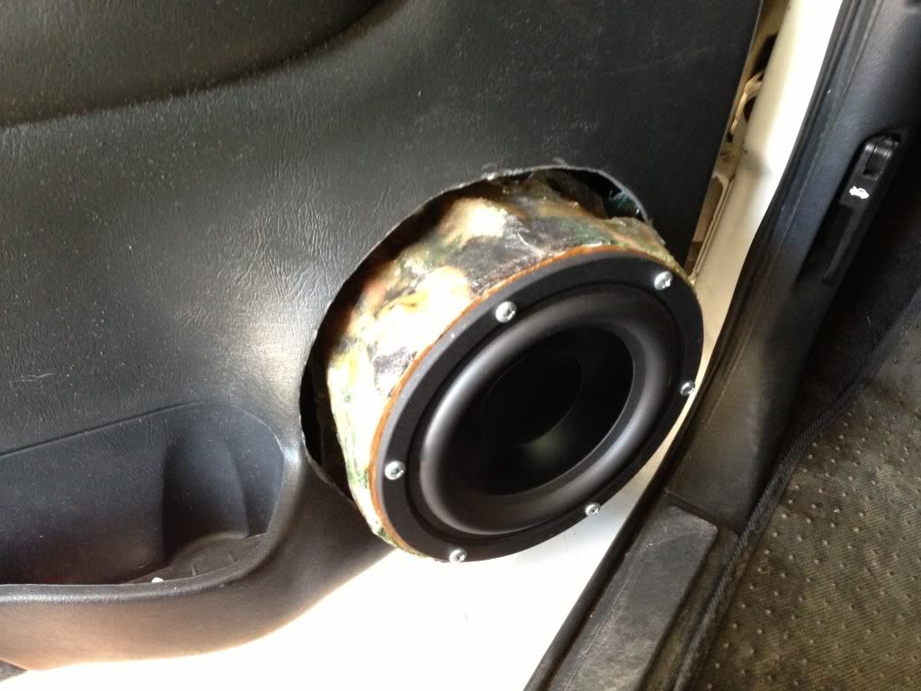

Alright, so I'm hoping to get down to Heatwave in October, and looking to see what I should do this month. Budget is only allowing on or the other.
My front doors currently look like this:
My first option is to get them fiberglassed. They would get a lower half fiberglass treatment. Woofers would be flush mounted, covered and protected, and also in sealed chambers.
If I don't choose to get them redone I would just cut out some rings to cover the woofers and cover all that in grill cloth. Would make it look the best I could.
