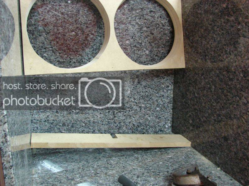

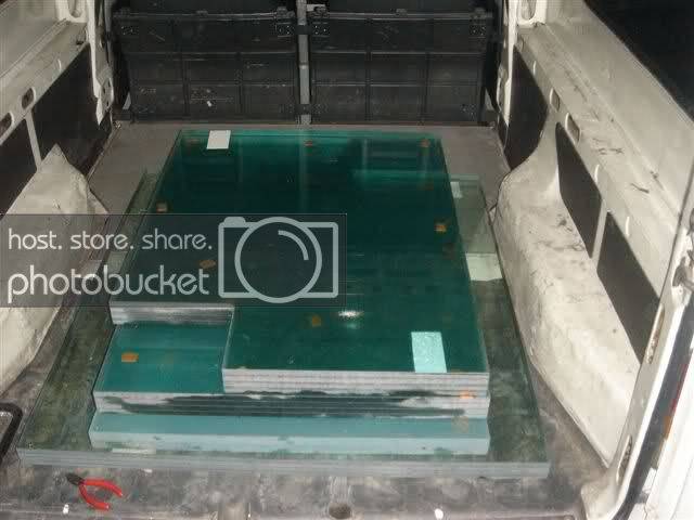

seen a couple super street No Wall class builds with a box made out of glass and one out of marble.. And a ton of layers of it at that and he did score serious numbers. Anything is possible. I'll look for his pictures.
I knew I had them somewhere..
1) this one is made of glass
2) this one was made out of marble
Yea It would look cool for sure but the price would be outrageous over mdf //content.invisioncic.com/y282845/emoticons/tongue.gif.6130eb82179565f6db8d26d6001dcd24.gif why not just do some windows somewhere on the baffle?
Good fucking god. Marble... jesus
the glass and marble boxes scored so high because they are so dense, dont flex at all built like that - and reflect all of the sound wave vs absorbing some of it using a softer / less dense material for box construction.
