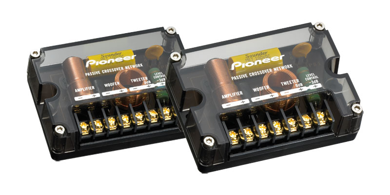

This is the crossover. You wire the tweeter and the woofer to their terminals and you wire the speaker output from the amp to the amp + and -
its automatically a 4 ohm load due to the crossover. now you wire it parallel to the 4 ohm coaxials in the back you get 2 ohm? Capisce?
