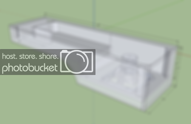

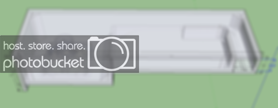

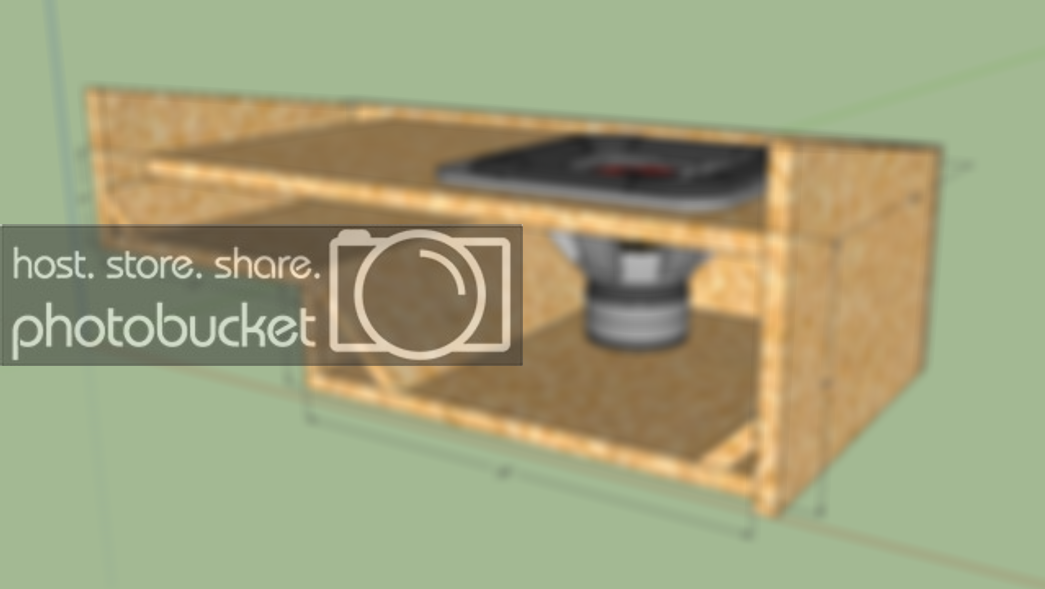

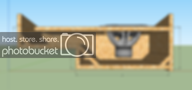

Okay guys. i put together a new box after doing some more research. Can someone please tell me if my math it correct. and which way i should aim the port.. forward or backwards.. against the back of the cab like in this design. If my math is right, this box should be 1.4 cubic feet tuned to 34 hertz. the port is 3.5x4"x23". Please give me some advice! Thank You!
