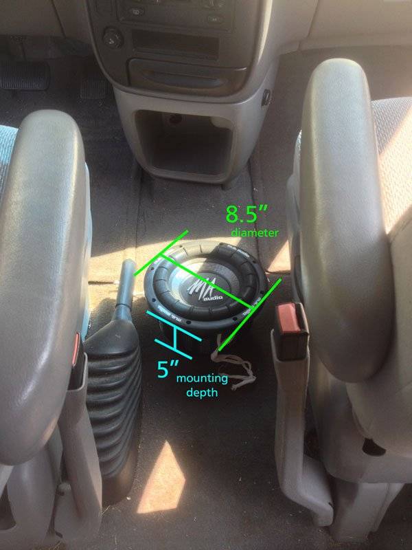

I'd like to retain the use of the cup holder tray, but I can live if the box ultimately interferes with it. I'd also like to keep the box in the front, so as not to interfere too much with the area for the next row of passengers. The only concrete requirement is that is it doesn't impede the use of the e-brake. I think given the space I should be able to able to put something ported together. If I could leave some room towards the back to maybe stick the amps, or have it tall enough at the front to mount the amps on the sides that would be icing on the cake.

I'm envisioning a rectangular box with slot port (possibly aero) flipped so both are facing down. How do I build it up to allow clearance between the box and the floor? I figure if I make the side longer to lift up the box it's sort of like lengthening one side of the port, which I'd imagine would affect tuning. Also, is there a rule of thumb for distance, or should I just stack books under it until I think it sounds good, then make something more permanent?

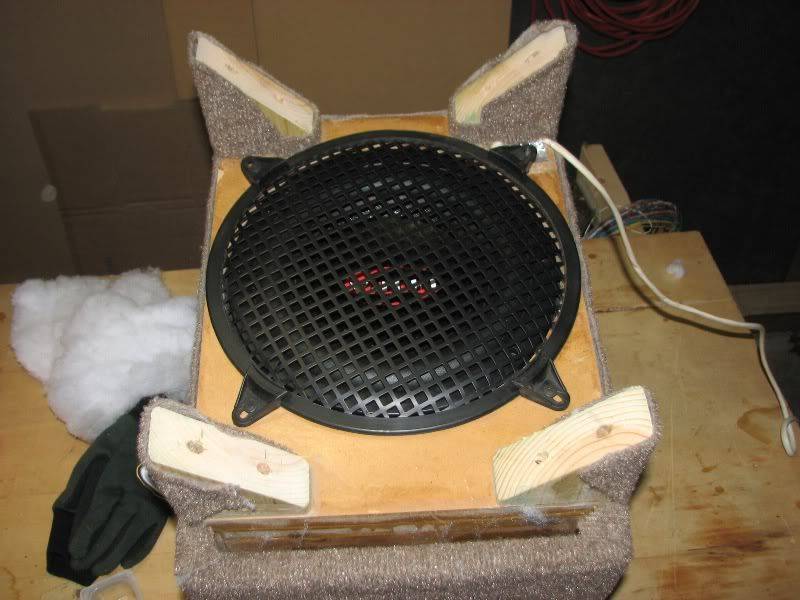

I made feet to support the box to keep it a few inches from the floor and the feet also acted as points to secure the box to the transmission hump.

Thanks for the visual aid, though I'm still trying to figure out how to do the feet with a slot port at the end of the box. It seems on these boxes one of the sides of the box also acts as a port wall. If I were to extend this side to lift the box up, it would also lengthen the port outside the box. I don't need the specifics, but this will probably skew the tuning, right? Should I reduce the port height (length? the longer measurement at the opening) to add feet above and below it, design it so the opening isn't all the way at the edge, or move two of the feet towards the center and away from the port, but altering the center of gravity?
It's FWD so I don't have a hump to deal with, so I'm either going to bolt some feet down somehow or, if I can get enough surface area flush with the floor, use some heavy duty velcro.
