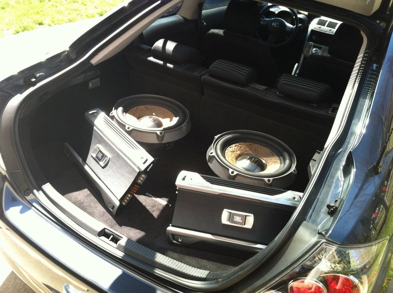

I was going port up in between the subs. That way the bass is pumping into the cabin area. If this ends up working then the factory carpet pull over will still be able to hide the subs.
I have tried sub/port up and sub/port back in my hatch and sub/port back is louder. I do like to look of sub up, but I will switch back. I want to try two tens up and port back.
