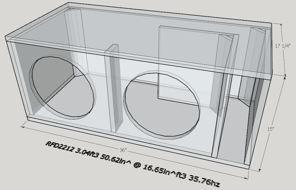

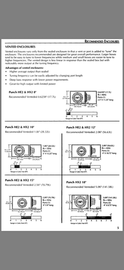

I was planning on getting one custom build but the cheapest quote for a 2 12” box tuned at 35hz was 350.00, so I’ve decided to build it my self, at those prices I can afford to mess up many times as I go lol. This will go in the back of a 01 Cherokee XJ. Speakers are 2 RF D2212 powerd by a RF T1500-DBCP I just purchased. Will be running them @4ohm. The recommendations are in the attachment but I’m using 2, so does that mean just double everything? I’m new to box building so any suggestions it appreciated. Amp arrives in 2 days so I’ll be shopping for the mats ASAP. Thanks
If I was going to run a T1500 (decent power) on a pair of those I'd be careful with airspace and port area.
That box you put up looks like it will really limit output to me.

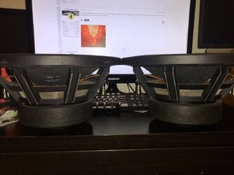

What kind of condition are the subs in? Those old RF's are notorious for saggy spiders when they age. I got a pair of Power HX2s in a trade 6 years ago but the spiders were sunk down 1/2 inch so I sold them on Craigslist.

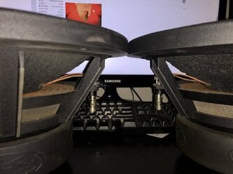

I had them since new, used for about 6 months then stored. They still look new, will take pics when home.

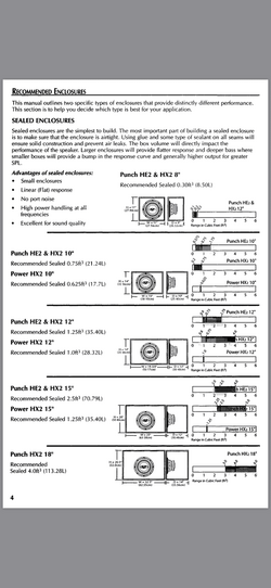

I might just build a sealed for now and see how they sound since I have the power to push them and that's what I had in back of the mustang. Any chance you can point me in the right direction on the dimensions of the box? I still will like to mess with a ported one by taking my time and building and hearing the difference.
In a Mustang?.. lol.. perfect... I'd try to keep it smallish volume wise with that power if it was me and look for output over extension. I'd build something the sub would like as that's pretty decent power your planning to run. Offhand I don't know what'll fit dimension-wise but this looked nice for me on that power (and it wont limit output). I'd just set the SSF with that tune in mind.

The subs look ok, just be careful of the one that is sagging a little.
