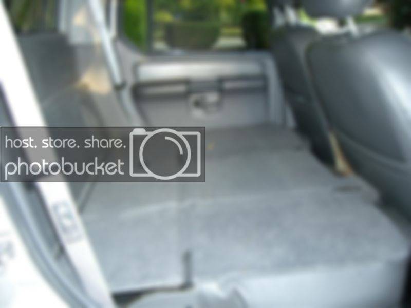

I have been putting a system together in my hatchback car and have it almost where I want it but out of the blue a new engine for my truck fell into my lap so now I am going to pull everything out of my car and build my truck.
Truck is a 2001 Ford Sport Trac
I am going to pull out the rear seats.
What I want to have when done is a flat platform on top and all the equipment under it.
The platform is for my dog to hang out on and for me to toss stuff on that I don't want in the bed.
I need the platform to be as low as possible so my dog can get on it from the rear doors as I don't want him climbing over the leather front seats.
This means I need to build a box that works with the hump in the middle of the floor.
I truly have more bass now than I need, I know that sounds stupid but it is true.
Subs are going to be facing forward.
Easiest cheapest thing for me would be to build a sealed box for my 12" Skars
This may put the shelf too high for my dog though.
Because of the hump I cannot make a normal 'L' shaped port
How would 10's or 8's sound if I did subs forward and an areo port facing towards the doors. I have never ran something like that. Basically 2 boxes each one with it's one areo port firing towards the door it is closest to.
Thoughts?
Anyone have experience with a build like this?
Here is a picture that shows what I want it to look like when done, this is how it looks with the factory rear seat folded down.
I could go a few inches taller than this.

So I have done some more looking at the area I am dealing with. The tunnel is not going to be as much trouble as I thought it would.
I am thinking amp rack on floor, then box on top of rack.
So now my questions are...
Subs are forward, where is best place for port? Forward or to side?
4 cheaper 8's or 2 beefier 10's?
Hmm....I built an amp rack with a hump in the middle like that.
I wouldn't put the sub enclosure on top of the amp rack in case you want access to the amps.
I am going to place the amps so I can get to the controls from the side that faces the doors. Shouldn't be a problem.
I have had systems where the the amps were built in the spare tire well with the sub box on top with beauty panels covering everything.
I will be using a Mini DSP so really just having the USB accessible is about all I am going to need.
