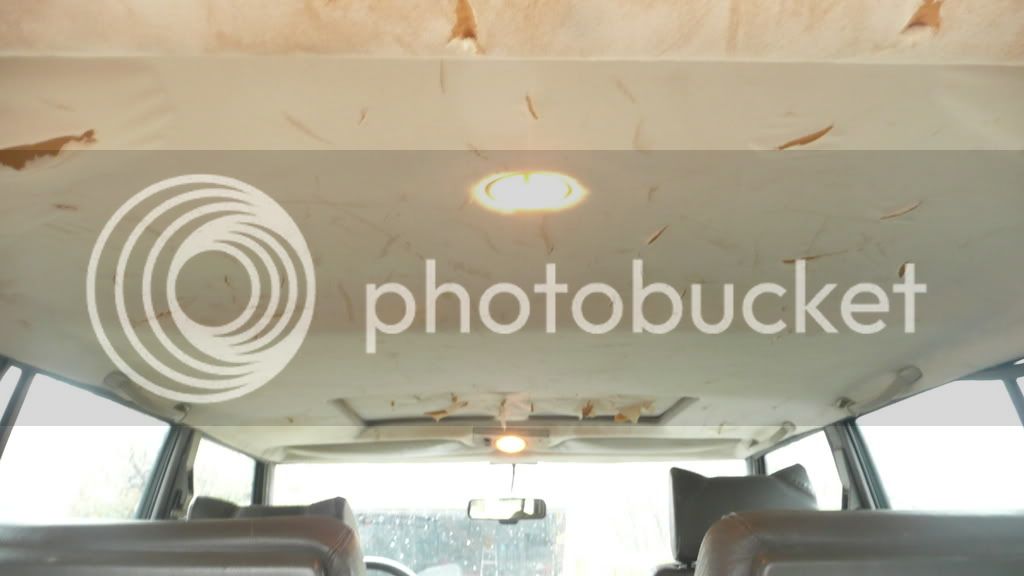

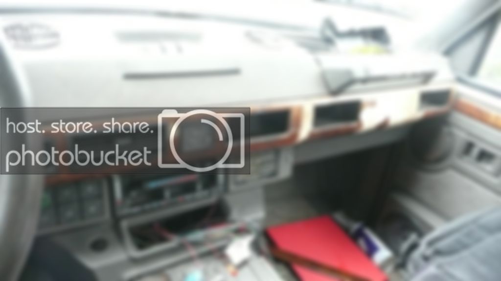

Bought it with high mileage and am in the process of restoring it
I have everything apart in the car as of now, im re-covering the headliner and getting new vineer
