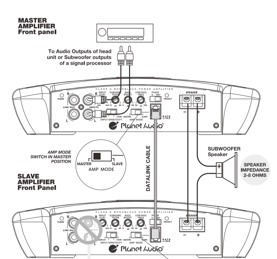

I have a P.A. torque 5000 watt amp that I want to strap to another one. But I can't find a strapping cable anywhere online. I've spent hours looking with no luck. And I'm assuming you have to have it to strap them. Please help!
I believe it's a standard telephone-type connector (the same as the ones used for most remote BASS knobs. Here's the manual, it goes over how to get that done.

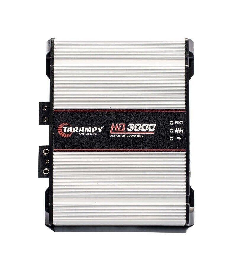

Additionally, the specs on that amp are all over the map. The PA 5000 puts out about 1300 watts @ 1ohm, that's it. strap another on (that's what she said) and it might double it to about 2500 watts. Before you go out and buy another, sell it and get this instead.
It's about the same money and it actually puts out 3000 watts or more and takes up half as much room as ONE PA 5000.1. In the end, when you double the output of inexpensive (poor-performing) power, you end up with, a more expensive lack thereof.

He wants to strap the amps to double the output to one sub. Some amps allow you to "couple" them. This allows you to wire up the one sub powered by two amps delivering twice the power at the same load. It's done with an rj11 cable.
