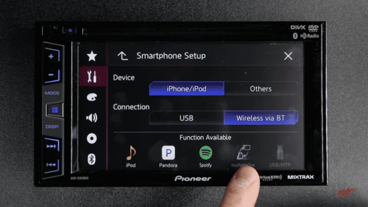

Actually, you know what? I may just be an idiot. Lol. I was watching another vid and saw this image. Now that I think about it, I don't think I set the Device to "others" again after the update and subsequent reset. I think I skipped over that, leaving it on iPhone/iPod. I'll double check when I get off work.
Mhmm. I've done a number of radio installs over the years, but this was my first one with any sort of smartphone integration. I'm going to blame Apple for this, making me take an extra step to setup my Android. XD

Well the phone type was the problem and things are working better (a few minor bugs, but I can't complain for the price I paid).  I blame Apple for this! Lol
