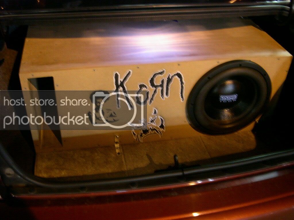

Messy, but got the job done
Box was 6 cubes after disp, had to take the trunk lid/hinges off and kick the box in
4 mtx 1501d's
G31 yellow top on each side of the box
With that body style Cavalier Ive found its easier to remove the rear seat and slide the box in the trunk. you can either 45 the top corners to avoid those angled parcel shelf braces, or you can aadd the top baffle after the box is inside the trunk. Either of these options give you more over all usable room in the trunk. Frankly, Im amazed you were able to force that long of a box in thru the trunk opening, it must be pretty short height-wise.
I had a hard time with my box that was 4.25 cubes. What are the demensions of your box. what year cavalier is that. I have a 03'
