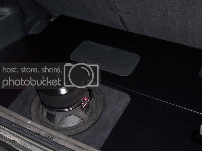

****pic request of false floors.****

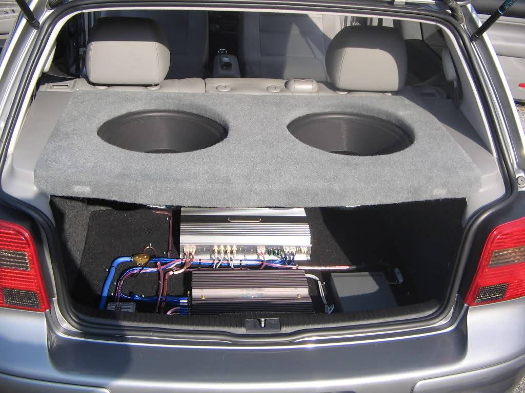

not my best work...this was a rush job I did for an ex-girlfriend.
JL W3v2 12's (in 1.4 cubes each, Sealed)
JL Slash Series 250/1
JL eSeries 2150
Streetwires Wiring 4 and 8 gauge
02 Lancer OZ rally edition.
I take it she didnt want to get rid of the spare? cause i dont have a spare anymore, so mine will be a bit more lower
I bet you could 4th order an 8" in a trunk, with a small amp (think mmats, perhaps) and you could have a decent little thump and no one would know you had a system. You could even put stuff on top of it. (except where the port fires up)
If I could get my trunk leakproof it may be an idea.
