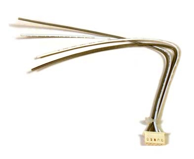

Tap both of the rear speaker wires and connect them to the high-level input harness wires on the amp. Don't use the RCA inputs.
Use this...
i didn't have this adapter. I've buy my sub and amp used. Use it on my last car many years without any problem whit RCA, but plugged directly on the back of my jobber radio. I think the left rca cable create sort, because when i plug it now, my amp stop work. If i unplug it, all is ok. Does it's necessairy, according have only one sub, and not two, to plug the left and right rca cable, or just only one do the same?Beause if not, i will need to unmount the door again...
