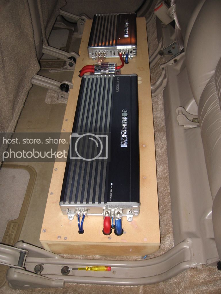

Speaking of "professionally job", can you tell me if this was professionally done by an installer or me?

Nope absolutely can't by a picture like that. Being a professional installer involves way more than making wires look pretty. I can be nit picky tho and ask the reason for the MDF box and the two 1/0 AWG wires going into the distribution box but only one 4 AWG wire coming out. Also your ground wire on the big amp isn't fully inserted into the terminal so you have the potential there for a short circuit.

Psh...pretty wires. But overall clean install. I see an MDF amp rack....where's the MDF box? MDF because it was scrap leftover....because it's easier to sand flat and costs less than birch. The amp rack was free to build w/o buying any more MDF. My ground is def in there....I think I may have cut too much of the insulation off.

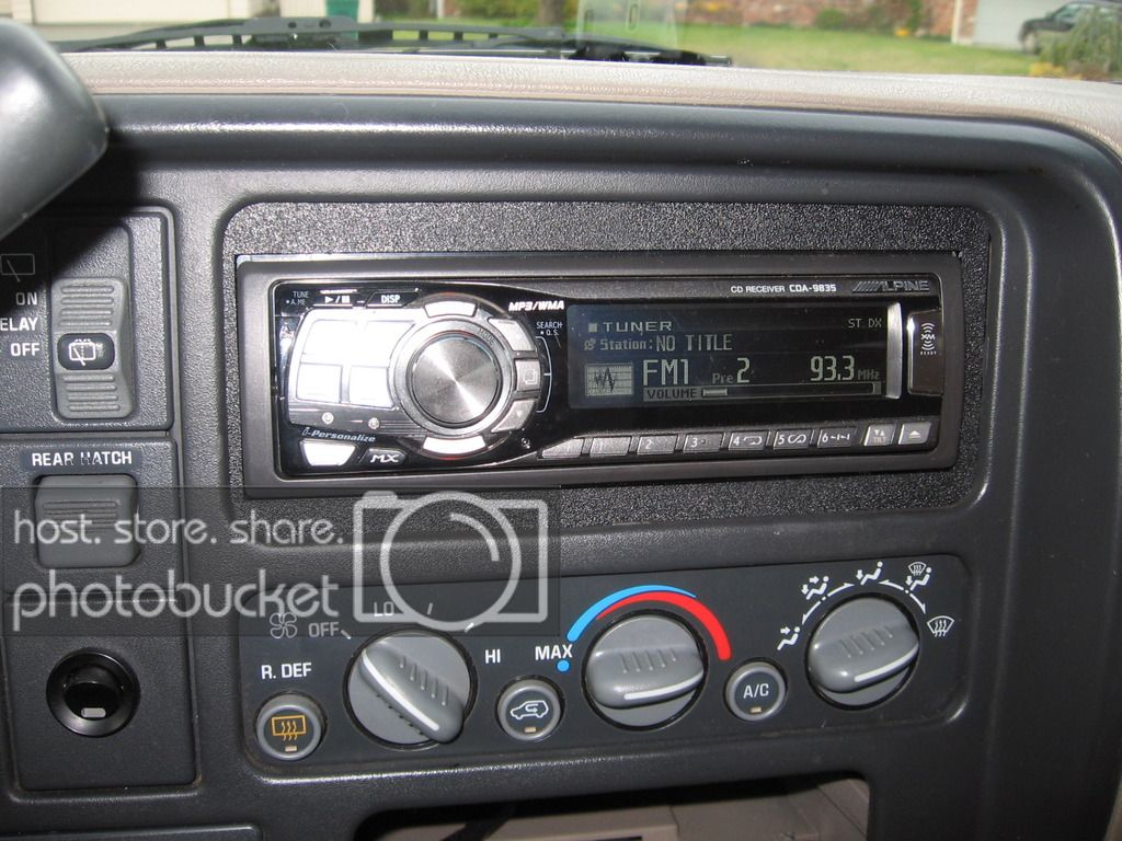

Few more pics for ya to drool over that I "professionally" installed...
s10 ext cab p/u HU

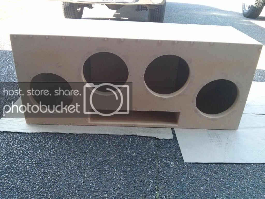

4 10's sub enclosure, made from MDF. Double baffle. Screw holes bondo'd and sanded flush, rounded corners.
Alpine 9835...
