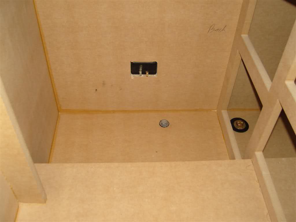

they're all ported. here's some pics of my new box, for your viewing pleasure. tommyk90 designed it, bj fisher built it. it should make some noise //content.invisioncic.com/y282845/emoticons/wink.gif.608e3ea05f1a9f98611af0861652f8fb.gif
that is a really nice boc. i like the way u did the double baffle. my next box will probably be like that. but just do like the other guy said and mx the sawdust and glue together and fill the hole. ive never thought of it.
