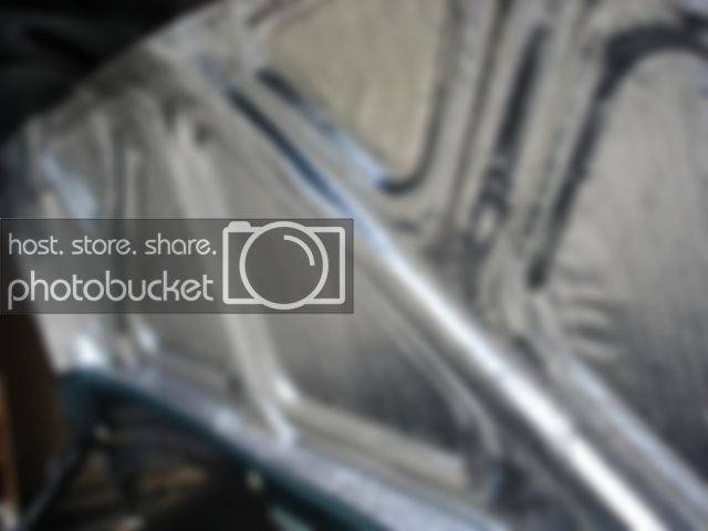

you guys were right, cut the holes and everything is fine now. but ran into another problem. i unscrewed the carpet off my trunk lid to see the dynamat that was 'professionally installed' a month ago. it looked like shit, indents havent even been pressed down so much of the dynamat isnt stuck to the metal, just looked like they laid it on in 10 minutes and gave the car to me. is there any way of removing this? or should i just cut air holes and try to press the mat down and layer it a second time?
if it's really bad then taking it off won't be that hard. i'd try to do it when it's as cold as possible and just take your time. if you happen to not get some of the residue off the new deadener will stick to it n/p. might be able to get a heat gun(like what people use for tinting, not blow dryer) and just finish applying what's there, don't remove any just heat and roll. i'd probably do the that first.
