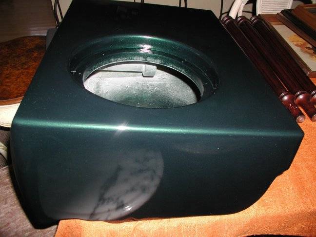

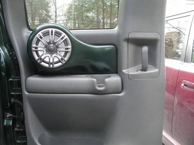

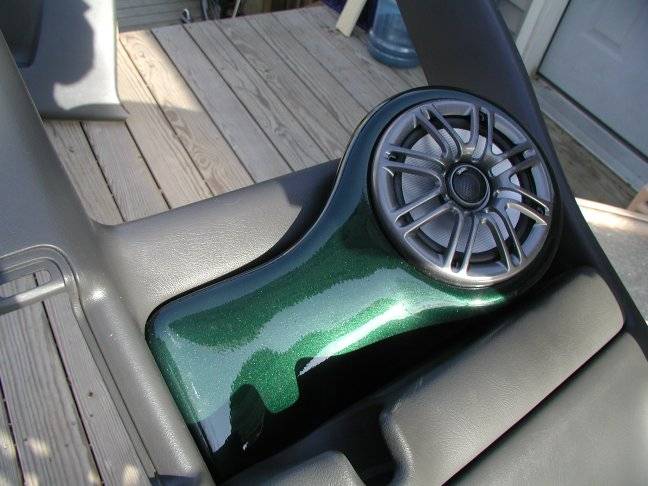

Rear door speaker pods and sub box color matched to body.
Pods are fiberglass but the box is MDF top and sides with the base fiberglassed to follow floor contours for added volume. The face was sanded with a belt sander to get the curve.
Thats automotive paint. 2 part primer, 2 part base and 2 part clear sanded and buffed.

that box for a Type R! are you kidding me? get a nicer subs bro.
It was my my first attempt at a system for one of my cars. First sub I have ever owned for that matter. Didnt know any better back then. Just wanted Alpine //content.invisioncic.com/y282845/emoticons/rolleyes.gif.c1fef805e9d1464d377451cd5bc18bfb.gif
One day I will get a better sub and amp. I bought a TC9 12" to put in there. I was going to cut it up and modify it but I wound up using that sub in my shop //content.invisioncic.com/y282845/emoticons/biggrin.gif.d71a5d36fcbab170f2364c9f2e3946cb.gif
how much did the paint run you
Cheap HVLP gun 75 to 100 dollars
Paint was 167 dollars from a buddy of mine. I got enough to paint that box twice plus the pods and enough to do the front pods which I abandoned. The work was good but I didnt like how the design turned out. Into the dumpster they went.
