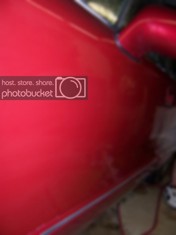

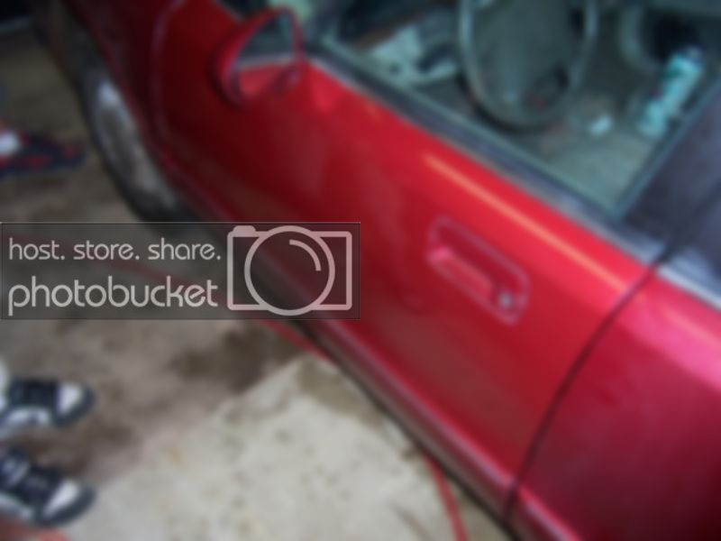

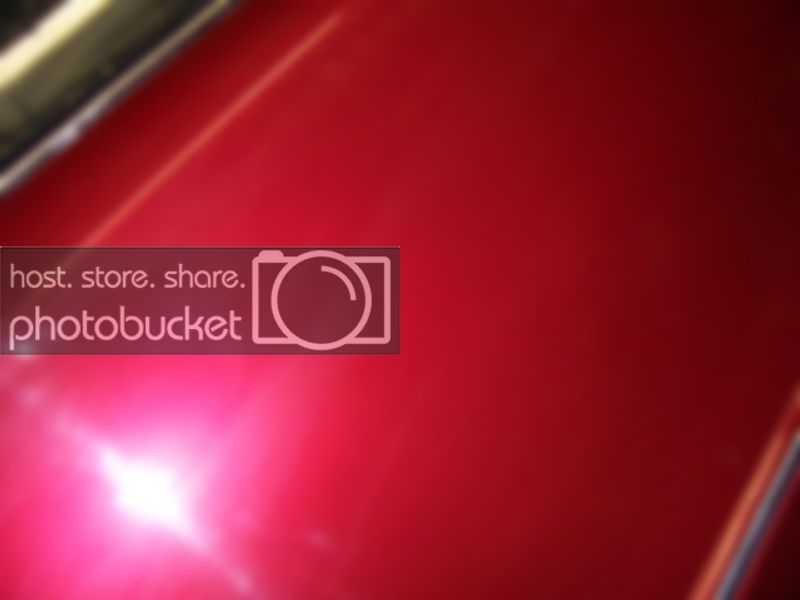

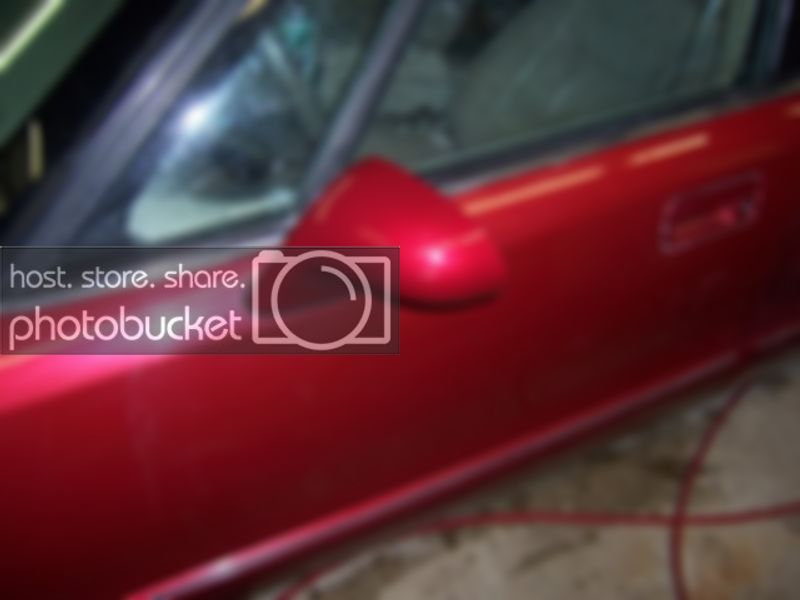

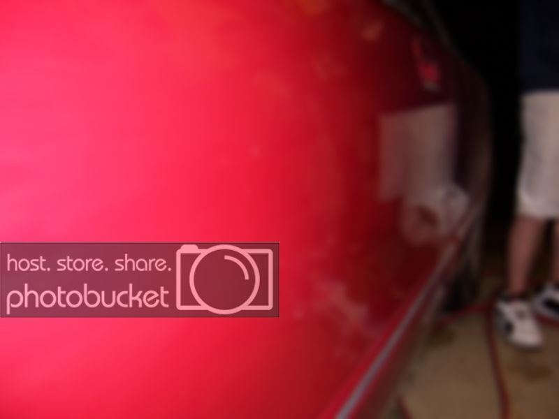

Here it is after I finished wet sanding with 1500, then 2000, then a really good rub with rubbing compound and polishing compound, followed by a light spray of wax.
Note- Theres a little shine from the flash and the wax in the pics
Input?
Theres very minimal orange peel, maybe lightly in a few areas, it looks better than factory but not by enough to stand out. I could have wet sanding it heavier to smooth out all the clear but I didnt want to make it look too good. The end result is perfect imo //content.invisioncic.com/y282845/emoticons/biggrin.gif.d71a5d36fcbab170f2364c9f2e3946cb.gif Now the car needs a good cleaning, run down with rubbing compound and polish, and a nice waxing //content.invisioncic.com/y282845/emoticons/wink.gif.608e3ea05f1a9f98611af0861652f8fb.gif
