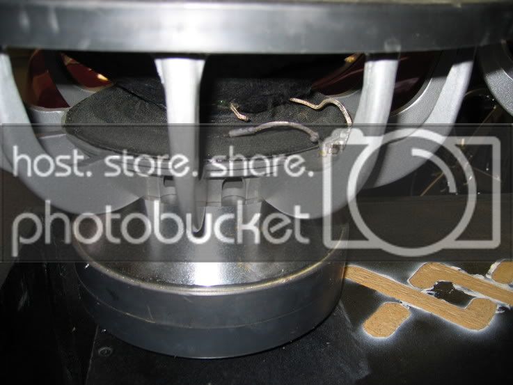

Reason for getting the 18" MT. Blew the + tinsel lead sides off first time....and then i resoldered them and they blew again so now i have to send back because they are too short to solder again now.

you can get tinsel material... or just put a piece of wire there and use good solder and good joints and heatshrink it on there .... it won't ever break again that way unless you're putting some serious force on it
