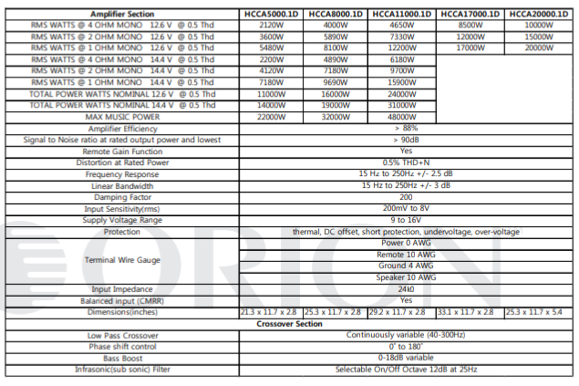

I have them in an Orion stage 3 ported box at 40 hz. These are the specs

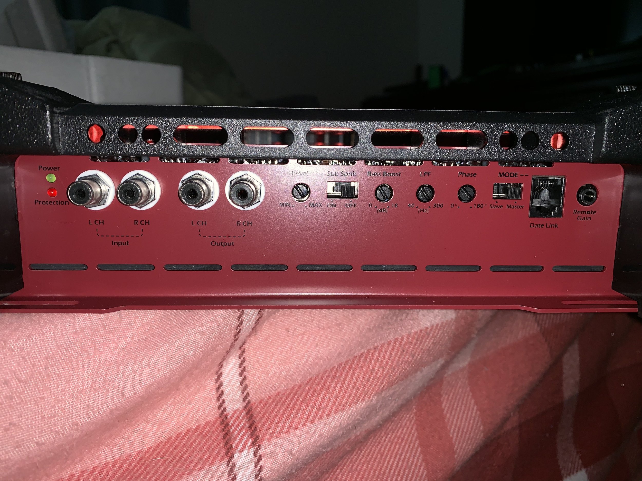

Ok yeah you’re right, sorry it’s been probably 6 months since I looked at the amp. Here’s a picture so you can get a better idea. So these aren’t what my amp is Actually set to right now. This was an out of the box picture I took so ignore all the current levels where they are but Atleast you can see what I see. So currently I have the subsonic filter turned off, it has never been turned on because frankly I don’t even know what it does. If you can’t tell I’m more of the guy who builds the systems and lets someone else tune it generally.. but I’m trying to learn so bear with me. I’ve tried doing research online but nothing really sticks unless I’m really shown how to do it.. I really do appreciate your patience
Turn that sucker on man... its a set 25hz which I think is bs but it'll help.
with your power and tuning I'd guess a 30hz setting or higher would be best but it is what it is...
Set 25hz setting at 12 db/octave... Orion shit.
