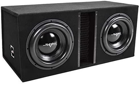

I had 2 2000 rms watt subwoofers connected to a 4000 watt rms amp now I have 4 2000 rms watt subwoofers hooked up to the same 4000 watt amp which should be louder?
Skar Audio Dual 12" 5000W Loaded EVL Series Vented Subwoofer Enclosure | EVL-2X12D4

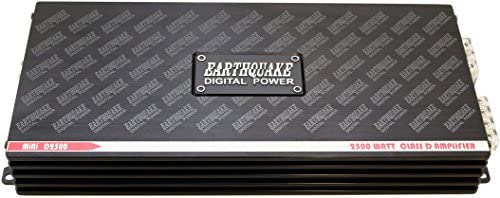

Wiring 4 of those together would make a .5 ohm load. That amp is not stable to .5 ohm.
That amp also has a 100 amp fuse rating so it's not going to do anywhere near 2000 watts rms.
If you have not bought the subwoofers yet I would recommend going a different route completly.

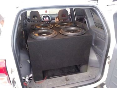

That amp sucks, and for 4 1250w 12s? I'm assuming they're Evls? Prefab city too... yeesh. Whatever you do get a custom box designed & built. And legit power is a must, not some cheapo amp. Cone is king for sure but with 4 12s you'll need SOME power. This is 4 RS Gold 15s tuned 30hz in a Rav4, temporarily hooked up and wired 2 ohm on a Smart3. It's actually getting down. (not my amp or I'd try .5) Once he grabs another Smart 3 it'll be 1 ohm ea and a little beast. He's got a hi output alt and headway bank in there now, so I think another Smart is just the ticket.

2 prefabs might not be the best way imo.
Enclosure makes or breaks any setup
Pretty much the only thing id keep of your planned gear is the subs and without the prefabbed enclosure(s). Get a single enclosure that will accommodate all four subs. Maybe taramps 5k if you are short funds, and an 8k if you can, lots of electrical upgrades. Otherwise, get one pair of those subs and put the money saved into a better amp like a 3k. Lots of electrical upgrade still applies
