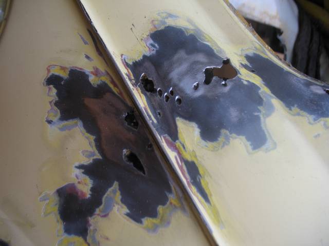

Every Beetle from the '60's - 2000's had spray foam or expanding foam applied to the C-pillars. Every single one rusts out in this area, except in desert climates.
Do yourself a favor and follow my advice about not using spray foam. I used to restore these for a living. //content.invisioncic.com/y282845/emoticons/wink.gif.608e3ea05f1a9f98611af0861652f8fb.gif
