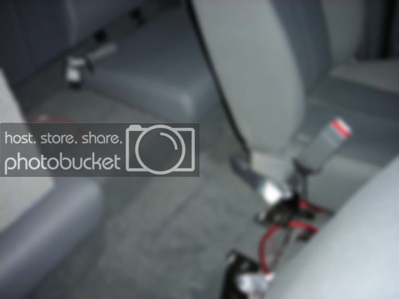

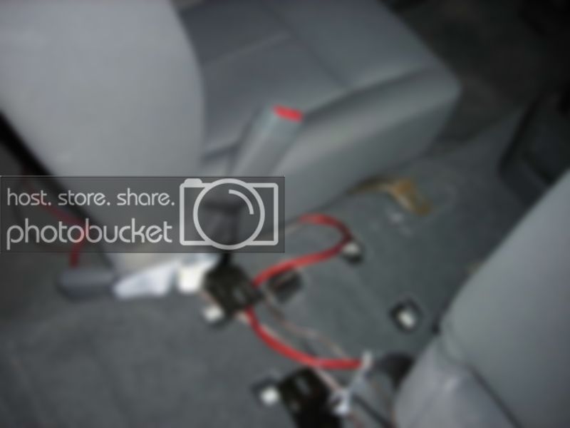

Here's what I am planning, what would you do if it's all you had to work with. I have 200 W rms x 2 @2ohm to work with.
I'm getting closer to building a box for my new setup. I'm planning on running 2 8's ported (Possibly Assassin's). The box should have an internal volume of roughly 1.2 cubes after port/sub displacement. Thinking tune should be from 35-40 hz for the 8's. Box will be in the cab of my CC truck where my center consol between the front seats used to be. Also thinking about downfiring the subs.
Would it be ok to have the subs share the same chamber?
If so, where should I locate the port in reference to the subs for best sound? Any thoughts on downfiring in a ported box?
Box shold be 41"Lx9"Hx8.5"W. Will probably use .5" mdf or birch...Will probably use 4" pvc for the port.
Hell, here is the space I've got...what would you do with it???
