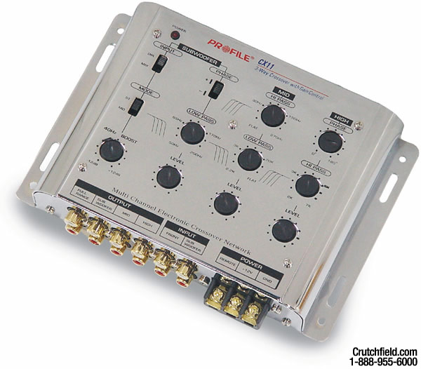

i also heard that I should buy a good crossover...so I was looking at this one
if I did get that, what do i do about the built in crossovers that coem with the speakers? Will they still be filtering out some frequecies even with this crossover? It seems pointless if its going to be using the speaker crossovers anyways..or is this just replacing the crossovers built into the amps?

The PPI PCX-480 has x-overs built in. LP/HP
Use the x-overs on the PPI amp to filter out all
the lows from your speakers. Still use the x-overs that
come with the components. They filter out lows from
the tweeter and highs from the woofer.
Use the GAIN controls on your amp to adjust the amount
of power you send your front speakers and your rear speakers.
External x-overs are good if you don't have x-overs built into your amp.
