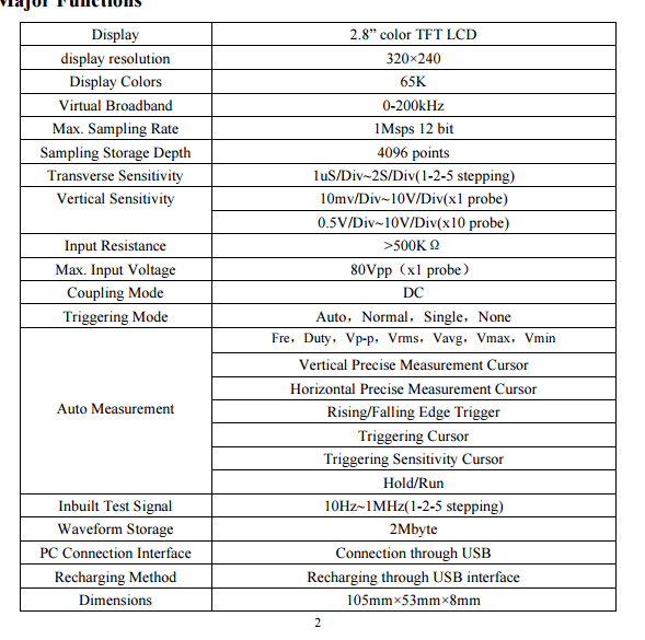

so i did a little research, and it looks like they'll just keep eating it up past where i thought without issue
i highly recommend you verify it with the specific user manual for the scope you buy as there are different models out there
note that the sensitivity is not what we want, we want the max peak to peak input voltage
