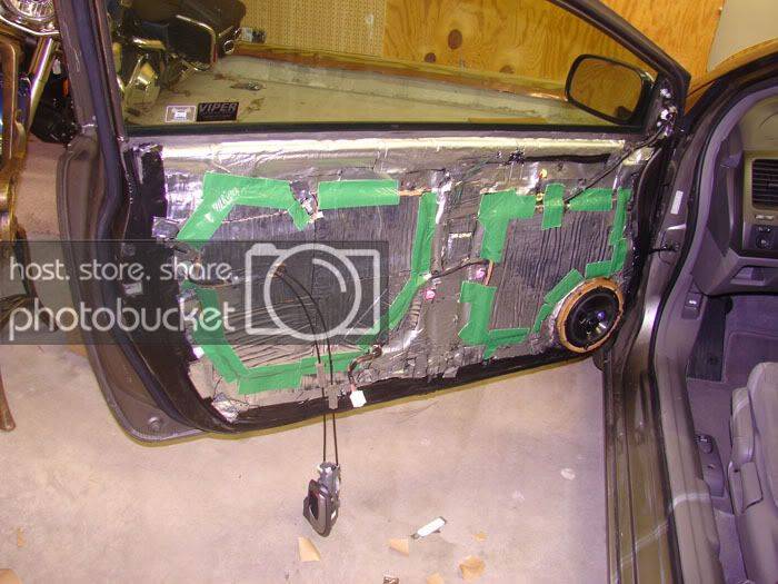

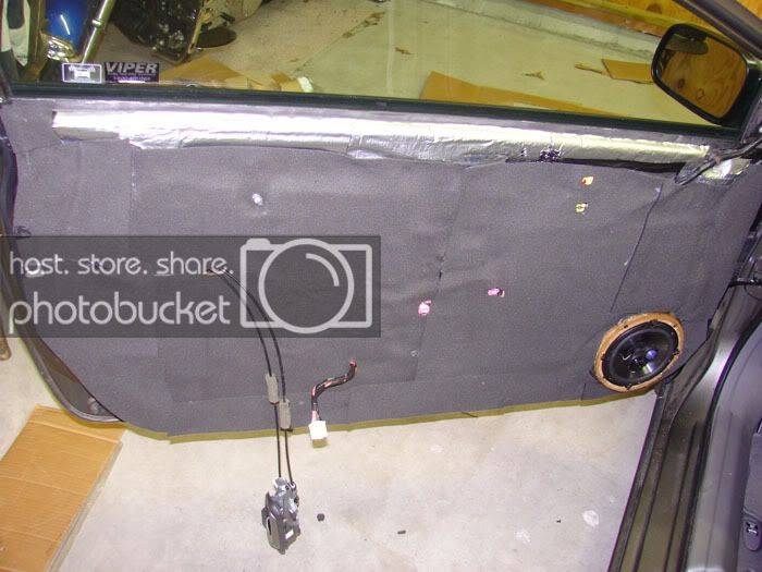

What car are they in? Where? Did you deaden the doors? I had CDT HD62 comps in my front doors of my old car, and the mids were very disappointing until I deadened my doors with a few layers and that's all I needed. Give us some info
Don't listen for specific frequency ranges (ie. midbass). If it sounds natural then there is nothing wrong. Good midbass does not equal loud or strong midbass. The point of sound quality speakers is to play a wide range of frequencies with as flat a response curve as possible, so that you won't be able to distinguish certain frequency ranges above that of others. If you want exaggerated midbass then buy an equalizer.
I have a 98 Acura 2.3CL with deadened doors.
