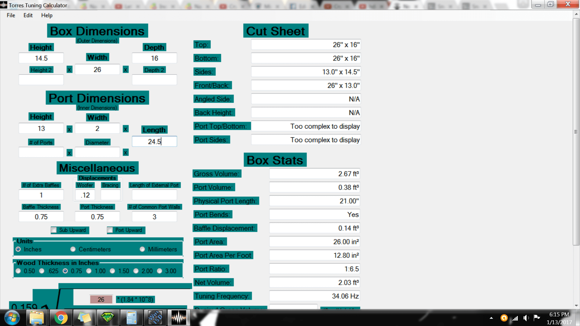

Here are my box dimensions, can you tell me how they look?
Width: 23"
Depth: 16 1/2"
Height: 13 1/2"
Gross Airspace: 2.27 Cu.Ft.
Net Airspace: 2.0 Cu.Ft.
Port Dimensions: 12" x 1 3/4" x 22 3/8"
Tuned @ 33Hz
Port Volume: .27
