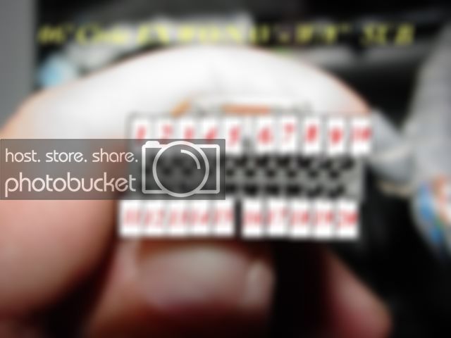

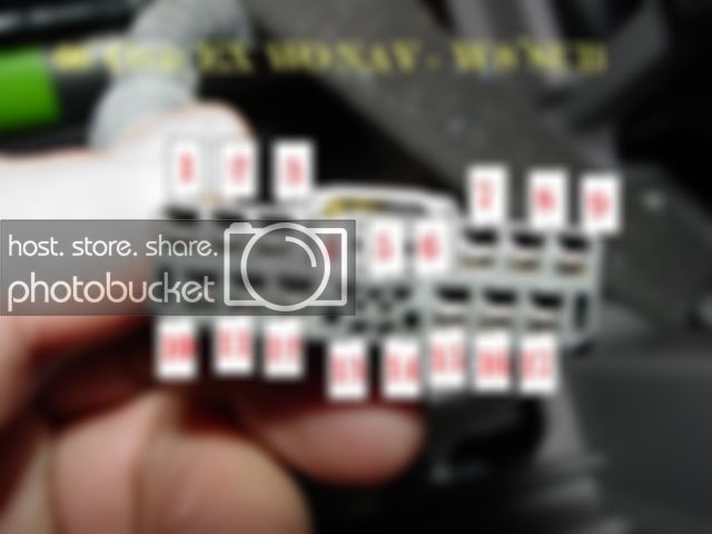

That's the connector I am working with. There are three but this is the amp one. Pin 15 is the amp turn on which is where I have the remote wire. Ex/Si are only models with the amped factory system. Pin 7 is the only other blue wire on that connector and I just tried that one and nothing worked, but radio works with Pin 15.

can you post the entire pinout of that diagram?
Metra has a harness for the Civic (70-1722) which I plugged into the Honda wiring harness. Then I attached the Alpine harness to the metra.
First Connector (this is the one I connected the Metra to)
#1 / Ground - Black with silver stripe
#2 / Rear R - Yellow with silver stripe

Second Connector (to factory amp)
#1 / Radio marking as TELMG No wire (EX w/nav?)
#2 / Radio marking as TELM- No wire (EX w/nav?)
#3 / Radio marking as HFT-11No wire (EX w/nav?)
#4 / Radio marking as REMC Pink (not used)
#5 / Radio marking as REMG Brown with silver stripe (not used)
#6 / Radio marking as AUXG Blue with silver stripe (not used)
#7 / Radio marking as AUXSH Flat black (not used)
#8 / Radio marking as AUXSG Brown with silver stripe (not used)
#9 / Radio marking as NAVSH No wire (EX w/nav?)
#10 / Radio marking as NAVG No wire (EX w/nav?)
#11 / Radio marking as HFT No wire (EX w/nav?)
#12 / Radio marking as TEL+ No wire (EX w/nav?)
#13 / Radio marking as HFT-12 No wire (EX w/nav?)
#14 / Radio marking as PASM No wire (EX w/nav?)
#15 / Factory AMP Power control wire Lt.Blue with silver stripe
#16 / Radio marking as AUXD White with silver stripe (not used)
#17 / Radio marking as AUXR Green (not used)
#18 / Radio marking as AUXL Yellow with silver stripe (not used)
#19 / Radio marking as NAVR No wire (EX w/nav?)
#20 / Radio marking as NAVL No wire (EX w/nav?)
