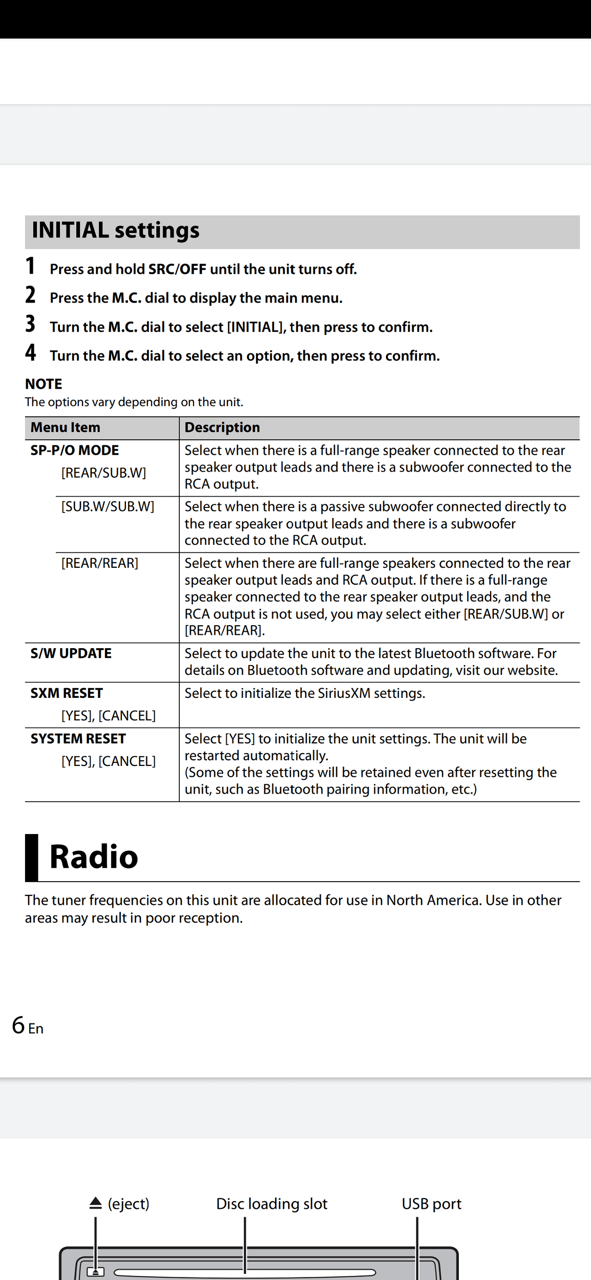

This attachment caught my attention. It is from the manual for your radio and has to do with initial setup. It states that to use rear rcas as a full channel you must select Rear/Rear. I do not know if choosing the wrong option would cause your issue.

The advice about the rear-Rear setting was spot on! The speaker was producing sound after being wired to the amp and the RCA cables were hooked up to proper rear head unit connections. Only issue I’m having now is only one speaker is functioning when two are connected to the same channel. I probably have the wires wrong. But really thanks for your help , it was spectacular! You provided good results.
