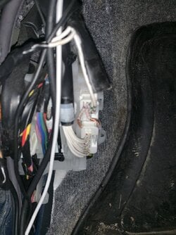

I attached a pic as to where I found the speaker wire spliced under the kicker driver side panel...no signal from the ends of these wires...I verified the speaker is in working order. I ran a separate speaker wire line to back of head unit to test with dash speaker disconnected and it ran fine. I am lost please help lol...
