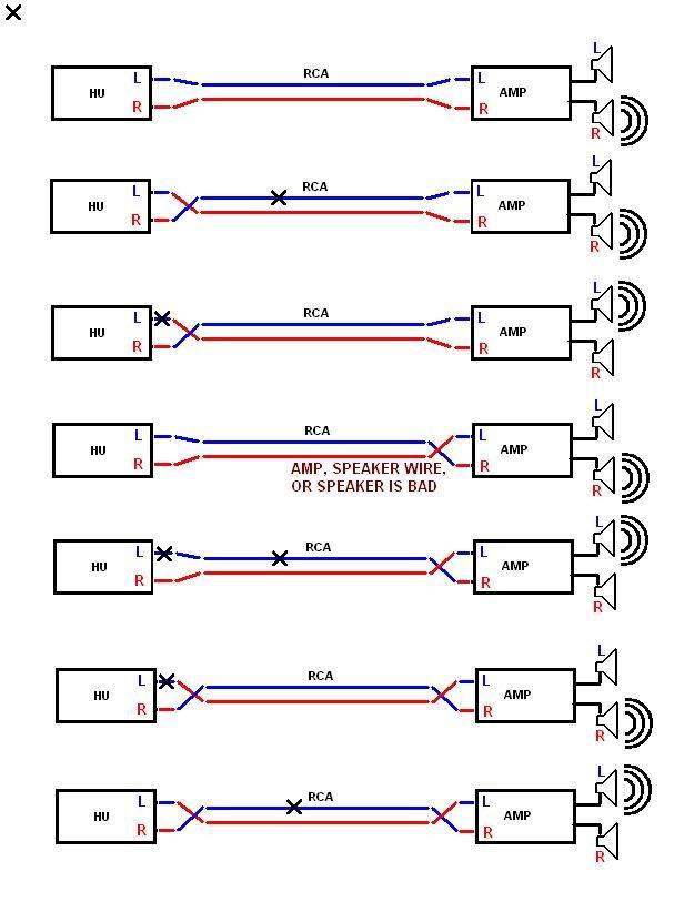

i made this for these instances.
X indicates possible failure. you can swap RCA's and speaker wires to narrow down culprit before your remove door panel.

moved the rcas in all ways and just that one dont work, im thinking it came disconnected at the speaker or its blown i guess
well my driver side front speaker stopped working in my car, i have my interior speakers hooked up to an amp, what way can i figure out whats wrong with out taking the door panel off, i have a dmm,,, is there any way i can see if it just came unhooked or blew or what?
Just swap speaker wires at the amp outputs to see if the speaker plays on a different channel that you know is working. If not, follow the wire and look for a pinch somewhere. You may end up having to pull the speaker to check the connections there...but work your way to the speaker from the amp.
