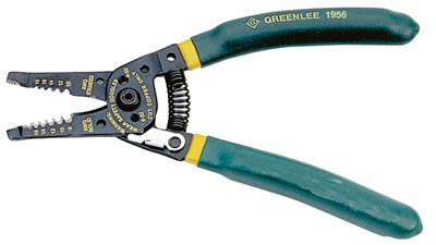

get some wire cutters that have the little teeth at the end like this;
and find the right wire gague for the wires you found, and bite down and wiggle a little (not cutting the copper wire). then move your strippers about 1\2 down the wire and repeat. then get a nice new razor blade like this;
