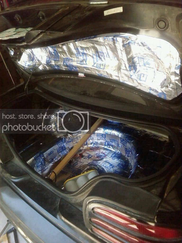

As for the build I started off by deadening the trunk and wheel wells, floor and doors and quarter panels. One of my main goals was to try to quiet down the drone from the flowmaster exhaust that dumps under the car. I do wish I would have spent a little more on deadener but oh well. Heres the first pic. Dont mind the car it needs some paint.... but not as bad as the pics make it look. I have been cutting/building everything in the same garage as the car is in so its COVERED in mdf dust.

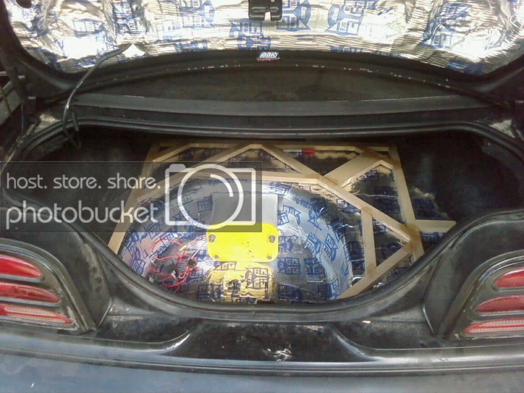

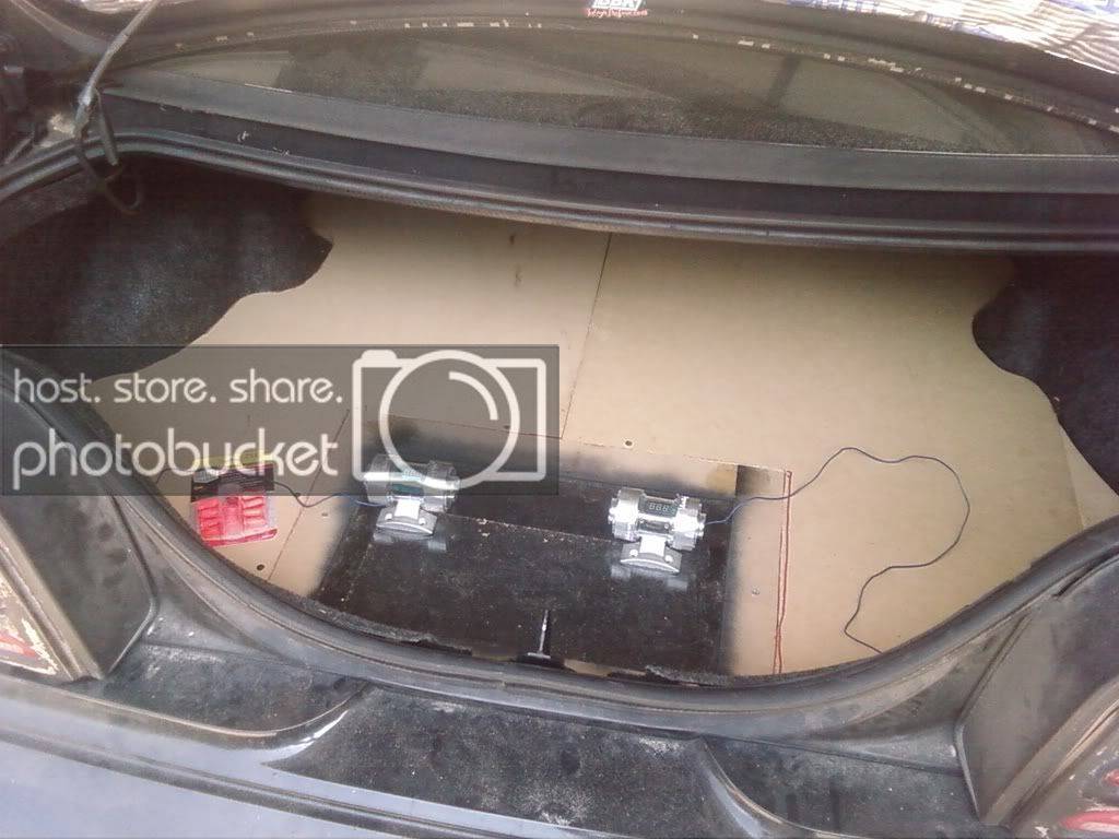

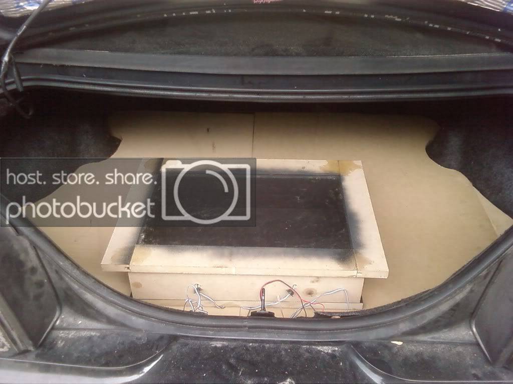

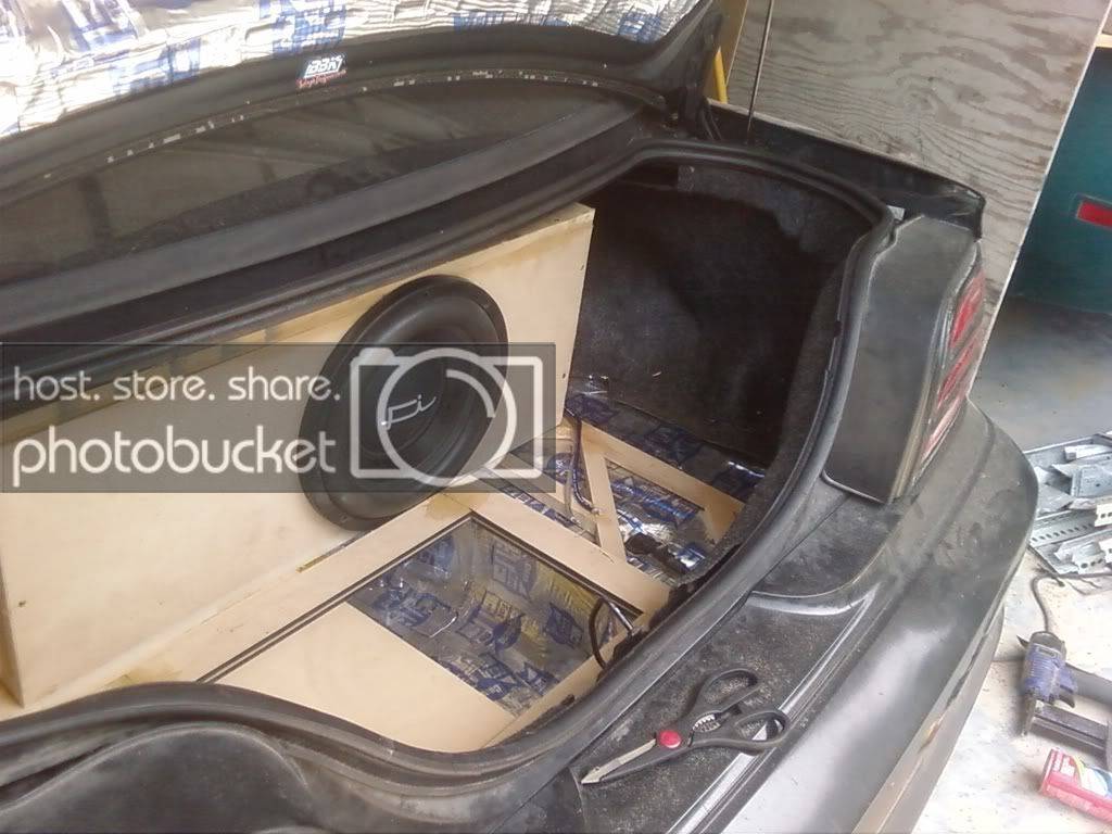

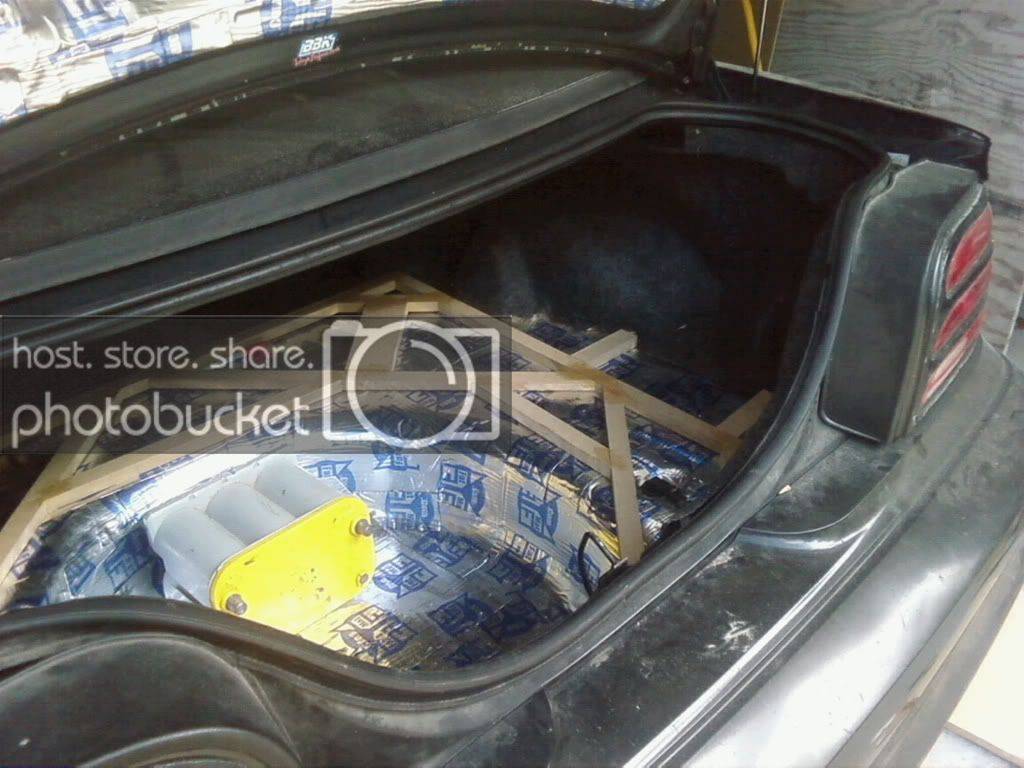

After deadening I threw together a frame for the false floor in the trunk. I also needed to make the floor a little bit taller to fit a battery in the spare tire area. I decided that I would try to be creative and put a plexiglass window in the trunk floor to "show off" some of the electronics. you can see parts of it in this next pic but its nowhere near completed. its just part of the frame of it, theres alot more to it, and I have only cut half of the floor. I got a little excited to see some progress.
and once again the window is just sitting there, it will be flush with the floor in the end.

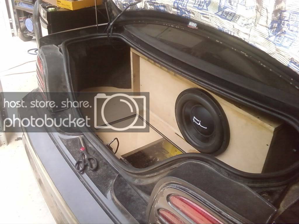

hmmm I guess I should mention something about the box size and tuning... its 2.6 cubes tuned to 40 hz. Its a little high for my liking, I tend to listen to alot of chopped and screwed stuff. The last box I had it in was tuned LOW I had it metered and the person that was doing it told me I peaked at 44 hz or something, I told him that it didnt sound right and when I was only doing an amazing 138 DB I knew something was wrong. I asked if I could screw around and play some stuff he said sure. so I went into the hard drive and tried some slowed down jeezy, which was something like 28 hz and the guy turned around and gave me a funny look and reset the meter, aparently I was really peaking at 27 hz. It ended up doing a 145.4 at the dash with the driver window down. So this time I am hoping to do alot higher of a number but it sounds like an 8" sub on that same slowed down song lol. That box was originally for a 15" sub and was around 6 cubes so its alot different now. wow Im rambling alot....

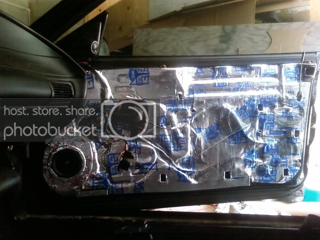

anyway heres a pic of a door with my amazingly cool pyle speakers....

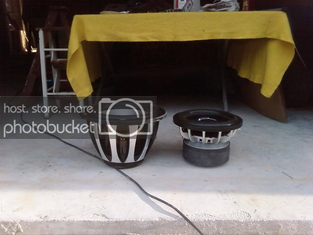

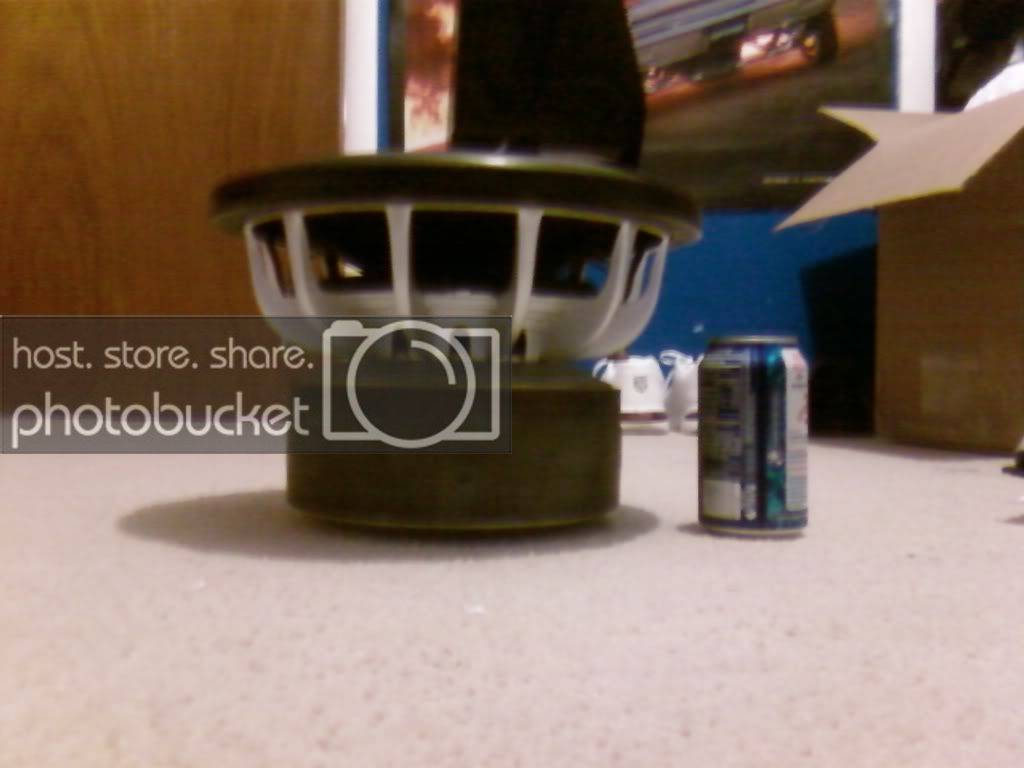

and heres some pics of the btl next to a pepsi can and a 15" orion H2

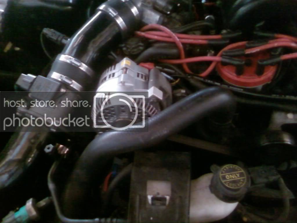

Heres the alternator and a little bit of the motor

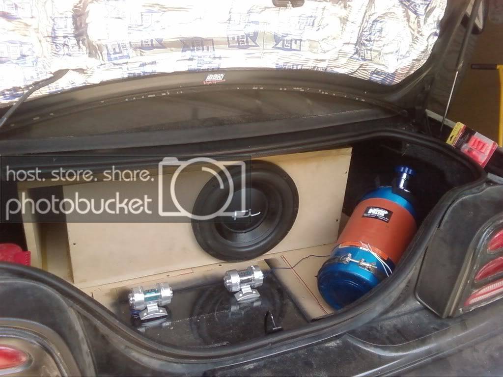

Hmmmmmm I guess the nitrous bottle will be mounted on the right side of the trunk and I have another battery that will be mounted on the left out in the open or something. Im still not 100% sure how I want to finish everything. I will probably just carpet it all or something....

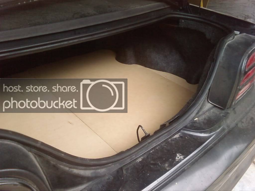

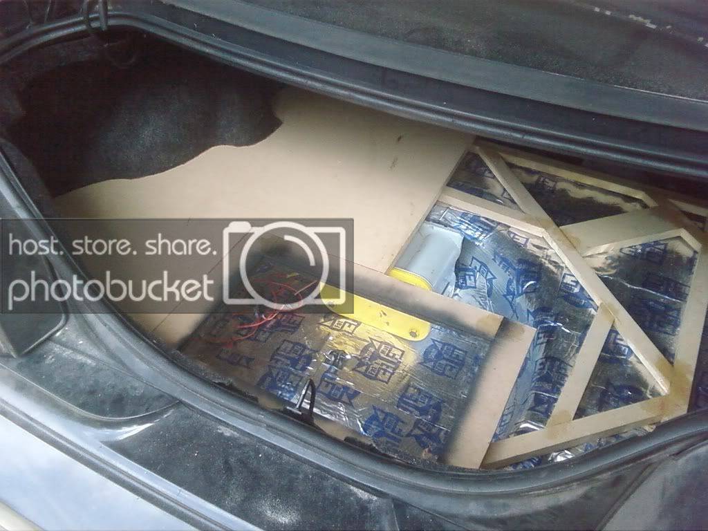

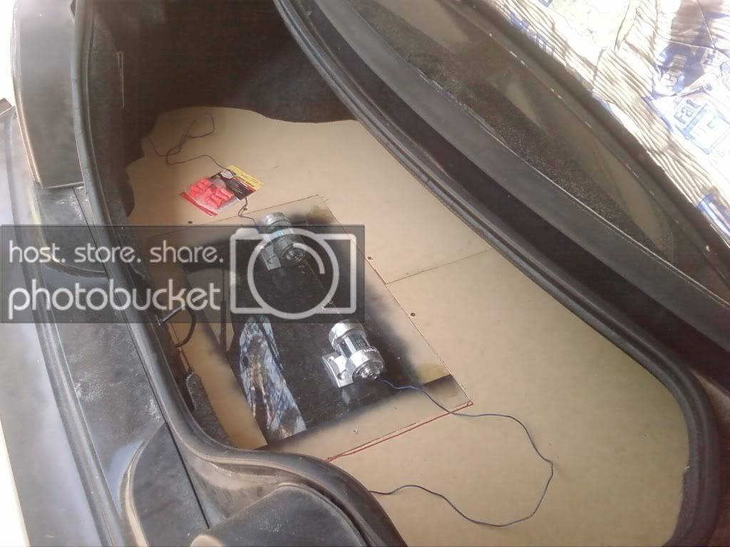

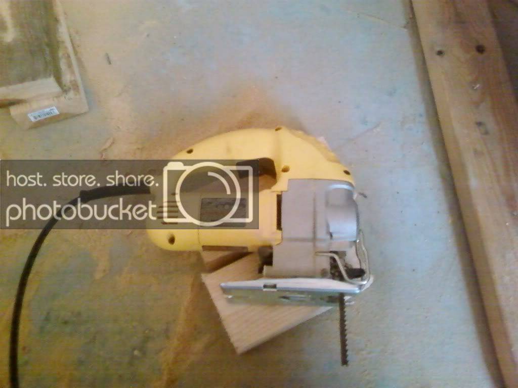

This morning I did some more work on the floor and finished the top of the floor... well I cut it all out, its still not permanant. I got half of it cut out for the plexiglass enclosure. I took some more pics of the floor frame and a picture of my new jigsaw that I picked up. I used to have a cheap black and decker bright *** orange one, and it finally took a crap on me so I went to home depot and picked up this dewalt that was on clearance. It really doesnt have alot of fancy features however it feels solid and the blade doesnt tilt when cutting and over all I would recommend it. heres a pic of that:
and the frame of the floor.
and ummm the floor nothing is screwed or glued at this point.

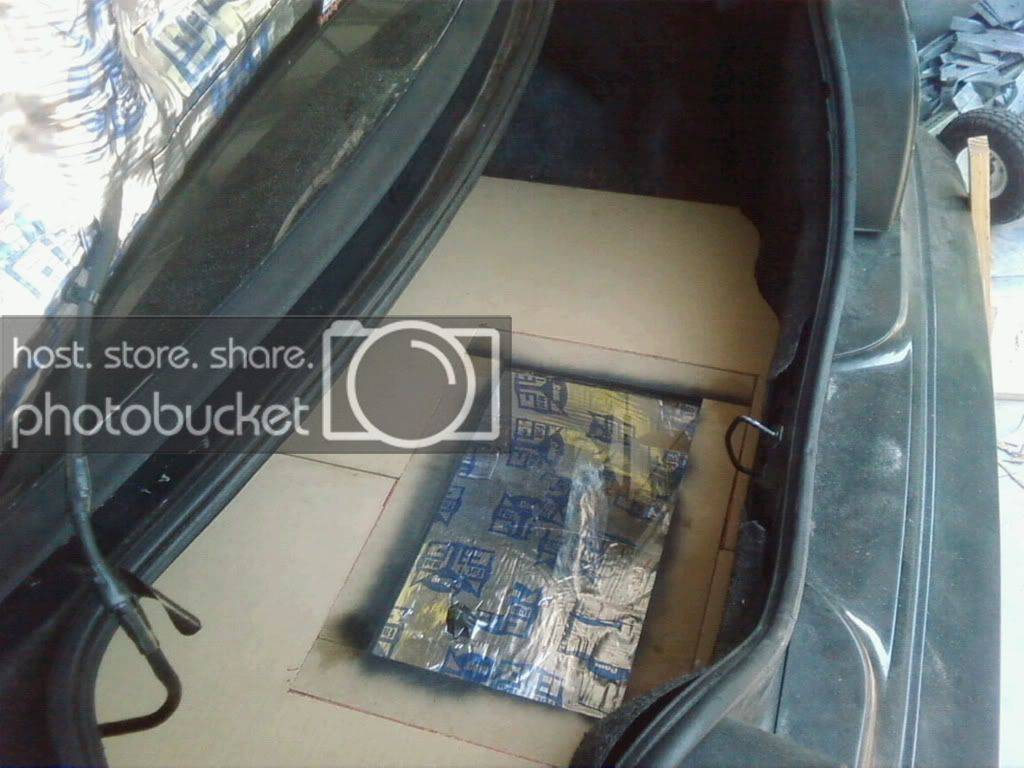

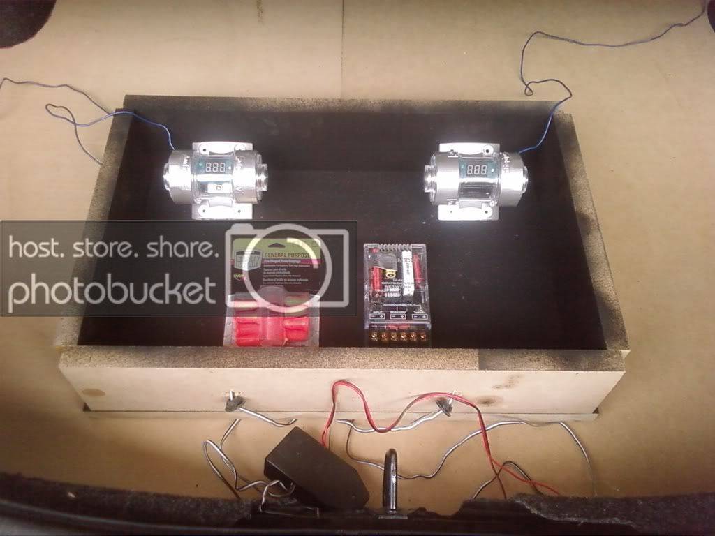

heres the enclosure, Im still not sure on how I am going to position everything or even whats going in there.

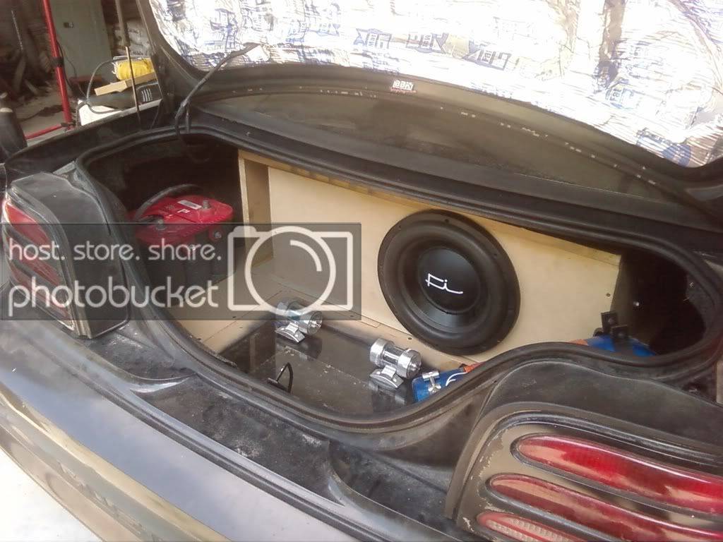

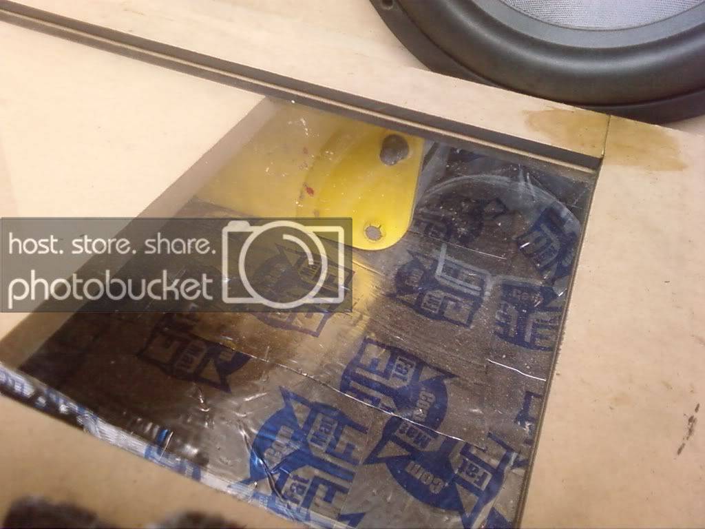

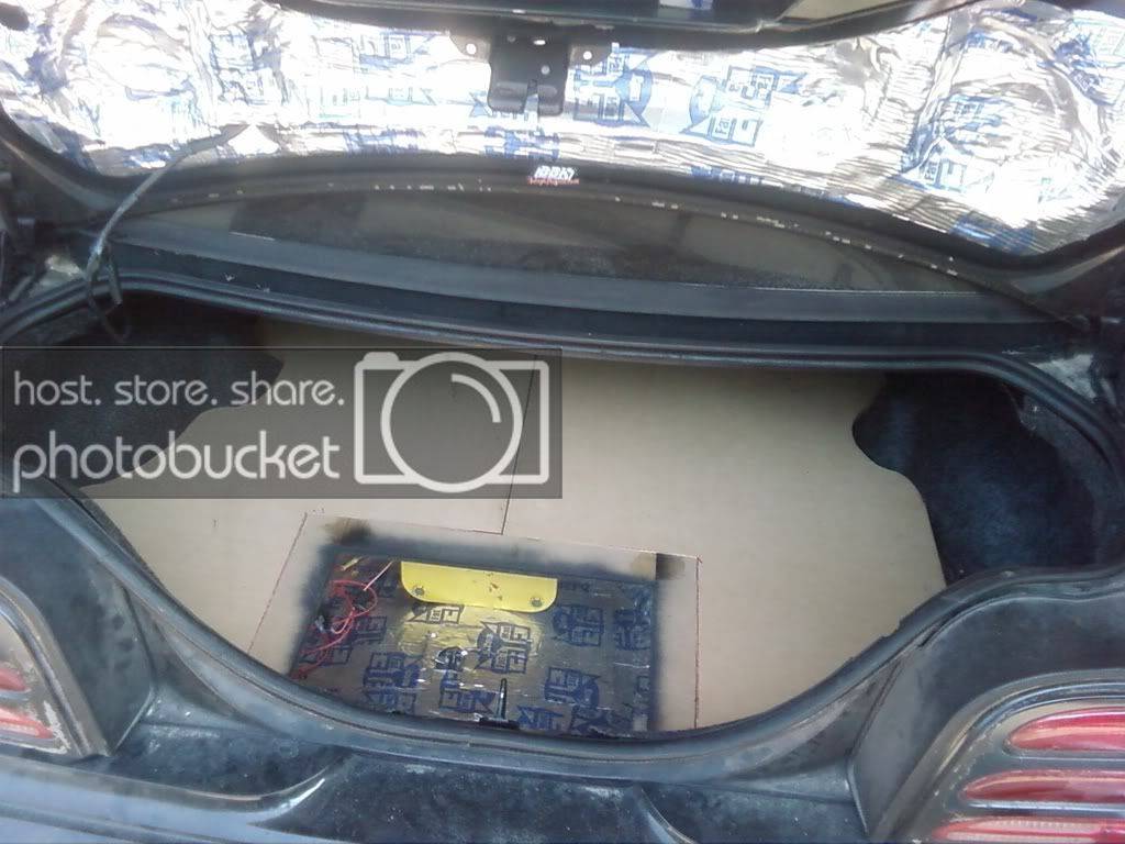

This morning I got the other half of the cloor cut out for the window thing and temporarily mounted the enclosure. its full of sawdust and stuff so its really not much to look at but when I finally got it in the floor on its own I stood back and it made me smile... lol
heres some pics:

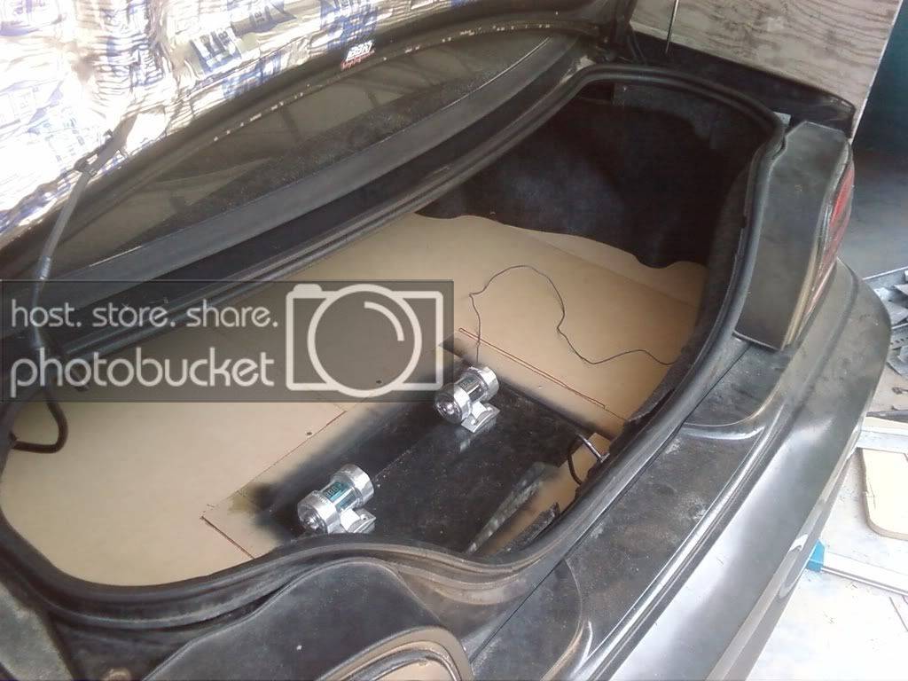

The enclosure is in and the fuse holders are sitting on top. It looks like there are a bunch or really shitty cuts or something but its a bunch of stray marks from my marker
This is pretty much what its going to look like when its done. Im still not sure what Im going to cover everything with.
anyone have any ideas or comments or anything? I have no idea what I want to do... lol
