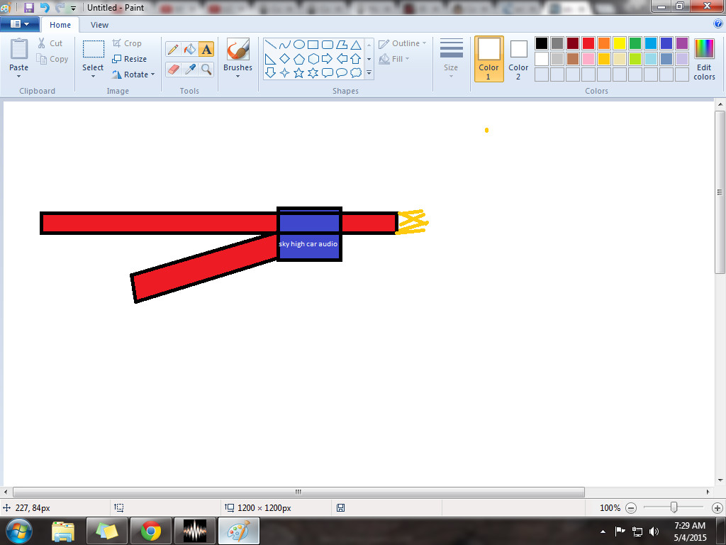

choke up on one wire, make a cut then Join/solder wires together. Then use a heat shrink to cover it. Then you only need to fit in one 8 gauge wire to the terminal.
kinda like this (doesnt need to be choked up that far)
Thx Jeff
I thought of that too. Right now that's what I'll end up doing.
