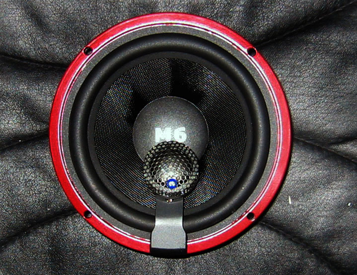

I'm not sure what power the M6 takes at 60-80hz but I know @100hz you can put 250wRMS a side. I'm gonna have mine @ 80hz with about 120wRMS on them. A team mate has them doing mid-bass duty and he says they are crazy, so I can't wait to try them out for mid-range.
My M6 Braxials
