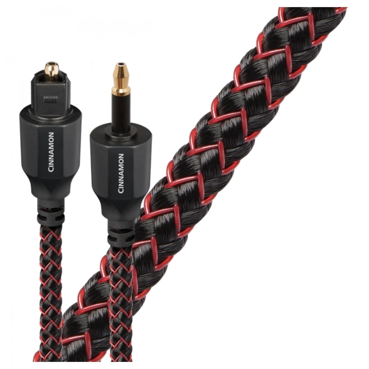

I will connect the A&K SR35 directly to the BCON via one of these.
www.av.com
AudioQuest Cinnamon Mini Toslink To Optical Cable 1.5m at AV.com

As a cheap experiment, how about using an external DAC dongle connected to your S23, and playing Hi-Rez files into your system? It would give you virtually identical SQ as the A&K unit, and only cost a few bucks so you can decide if the $799 for the A&K is worth the expense.
And cheapass that I am, I'll tell you not to waste the money on an Audioquest optical cable like that. It should be a sub-$10 item.
Hi Rob, would a cable like the above enable a digital signal to be sent out of the A&K,SR35 to my Audison DSP? Or would it only he analogue coming out of that 3.5mm output? I'm confused.....
From what I can see, that cable will not work at all, as the A&K only has balanced and unbalanced analog outputs. No digital available. No line-level available.
That cable is for devices that have special headphone jacks that are analog with a Toslink digital combined to save space (like the old Sony minidisc players).
You’d be feeding your system with an already-amplified signal, which IMHO would be a huge waste of $800.
To get the most out of the A&K, you’d still need to use an external DAC connected to it (assuming it supports one through the USB). I can get the same quality of sound you’d get for $800 plus DAC expense with a used $40 Samsung I just bought as a dedicated music player.
But if you’re dead set on that A&K, buy it plus an external DAC that has digital outputs and connect it to your DSP (assuming the DSP has digital-in) for the best quality.
