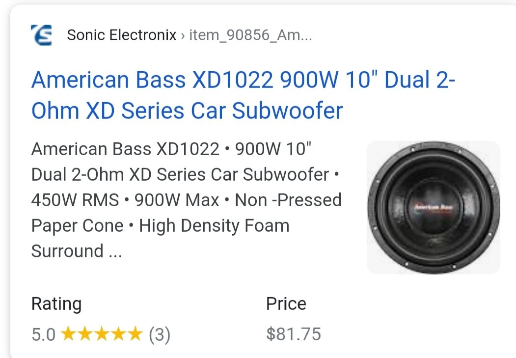

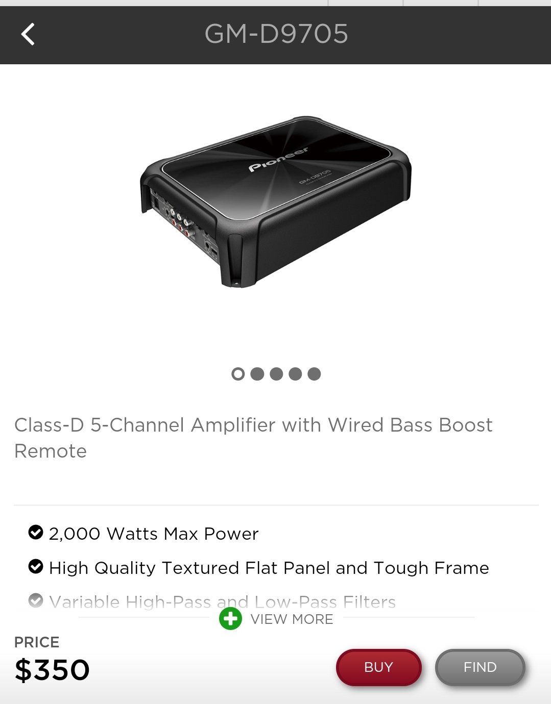

Dump the rear deck speakers and get a nice 5 channel amp. Run the the front 4 channels to your front 6"x9" and tweeters in the dash. There are a lot of budget friendly 10's out there. I'm an American Bass fan, so, a single XD1044. This is the amp and sub that should work for you.
