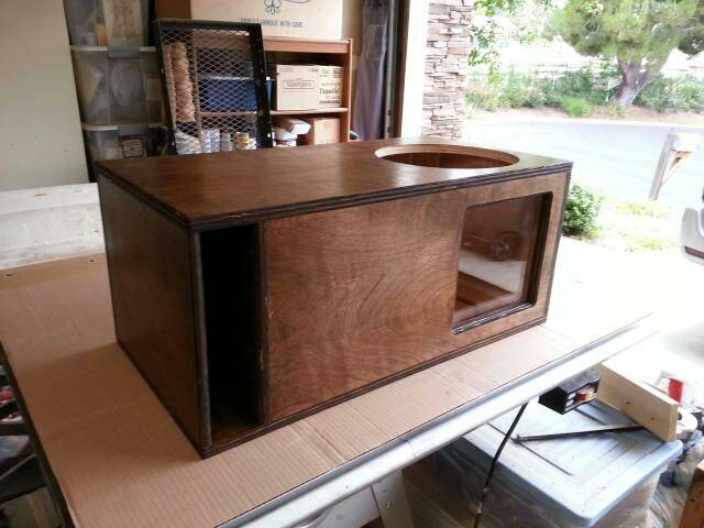

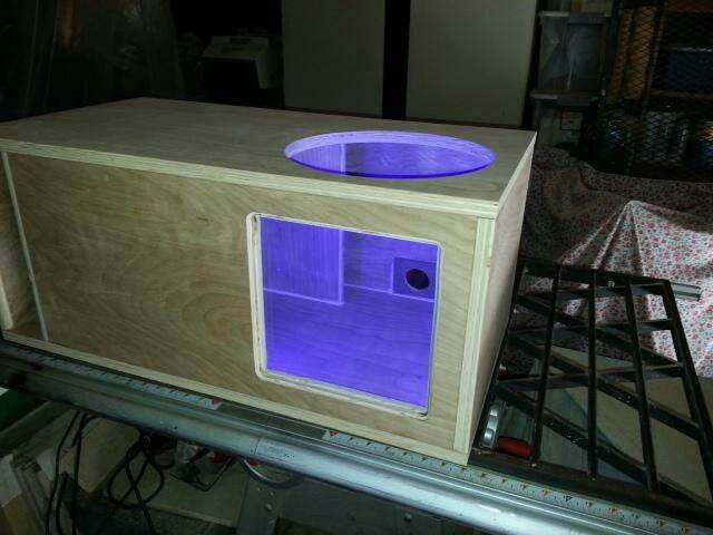

Here is the 12 w6v3 box he just built for me. He sent me these pics during the build, it'll ship out tomorrow.
Before the stain, LEDs on
After stain, LEDs off.
I'm in the east bay if you'd like to demo a single 10" in a proper ported box or the 12" in a week or two.
